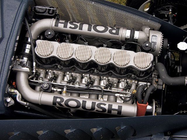

My dad took a 4 barrel intake off a 300 years ago and put the stock intake on it. He said it ran just as good with the stock intake on it. I think Clifford perf. has some stuff for the 300.
Clifford Performance :: Make 6 = 8

Apparently the problem with a straight six is the end cylinders starve for fuel unless the manifold is designed to compensate for that and sufficient fuel, but not too much enters the combustion chamber. The Clifford manifold is one of two I have been considering. Offy is the other.
The idea to switch engines was my first thought until I learned of the following for the 300 engine and the speed parts now available. Apparently it is legendary for it's torque and UPS still uses many of those engines. So do I swap out a perfectly good 10,000 mile engine that is a rodder's favorite or do I spend $5,000 to $10,000 on a drivetrain swap that I could get by without? That's why I'm thinking drive for a while I tweak the body panels, etc and then see how it goes and if I stumble into some other engine/trans/whatever?

That's sort-of what I've been thinking. Out of the box it has more torque than a lot of other things and with a cam and improved breathing I think I can get by. The 300 engine has shown up in a lot of hot rods lately.
Found this on the net...
