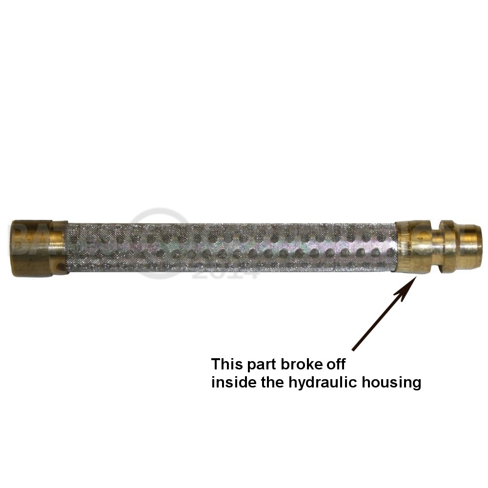

The end of the orifice filter broke off inside the hydraulic case. Any ideas on how to remove this end piece?
Anyone know what diameter the orifice is in this piece?
See picture below.
   / How to remove broken end of hydraulic orifice filter on a International 2424 #2
Can you post a picture..??
   / How to remove broken end of hydraulic orifice filter on a International 2424 #3
Get a new one and start from there . o-ring removing tool with a bent tip ?
   / How to remove broken end of hydraulic orifice filter on a International 2424 #4
If that groove is exposed, I'd make a tool out of a piece of 3/8" or larger rod, with, as mentioned a lip on the end to drop in it. Bend a piece of metal, or probably weld a piece of small angle iron on the end, to drop in that groove. Weld a piece on the outside end to tap with a hammer, outwards, rotating around it, as I tap. I have a slide hammer, with an end that would drop in there, if it weren't too long, similar to the two on the right in this picture. hooks.jpg
