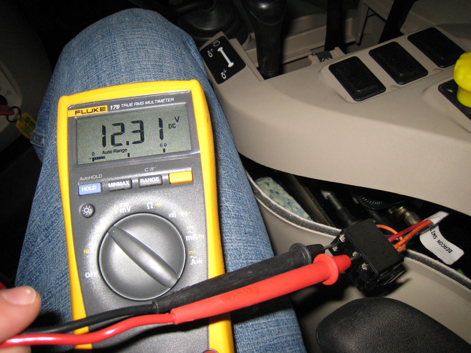

Currently, my biggest issue with getting this complete is finding a piece of orange wire that is 4 feet long:D
LOL.. this will be easy:D
   / How To Put Cab / Flasher Lights ON Designated Switch
#13
Well, I have located the 12 volt power source under the control panel on the right hand side. As the service manual states, wire 162C is hot. A simple blade connector fits perfectly in the slot. I will run a wire from the red wire in the beacon connector to the switch. Then a wire will go from the switch, under the mat (with the rest of the wires in the harness) to the dash, and up to the orange wire that will be removed from the switch. That will make the hazards independant. Then I will switch the purple wire into the orange wires slot on the original light knob.
We will have independant hazards:

Do you think this idea of going through the Beacon light harness will still work for me? Because I just had a Beacon light installed.... Do you (in your opinion) think it's too much of an overload to have the Flashers and the Beacon on the same switch? Or do you think it can work?
#15
We are only using this power to open a relay, so there is very little power draw. The power for the flashers comes from a different source. You would have to splice in the power instead of using a blade. There might be other power available under there for you to use. It all depends on who has what. If I were in your shoes, I would slice the wire and not worry about it.

If you dont want to splice at all, A person could make a "Tee" that would just plug right inline...Literally NO cutting/splicing/modifying of your factory harness.

In post 7 & 13, I describe how we would put the hazards in a separate switch and how the factory switch would work. This is how I think you want it.:
The red power on the beacon would go to a switch, from the switch you would run a wire up to the headlight switch. You would remove the purple wire from the connector one the back of the headlight switch and plug it in to the switch wire. That would give you worklights whenever you want.
Without doing anything else, you would have a factory switch that was:
off
hazards
hazards/headlights
headlights
I would think that would work well for you as there might be some time you would want to work without flashers. But, if you want flashers on whenever lights are on, you would have to run two wires with doides on them from the worklights and the headlights, to the flasher wire. Then you would always have flashers.
