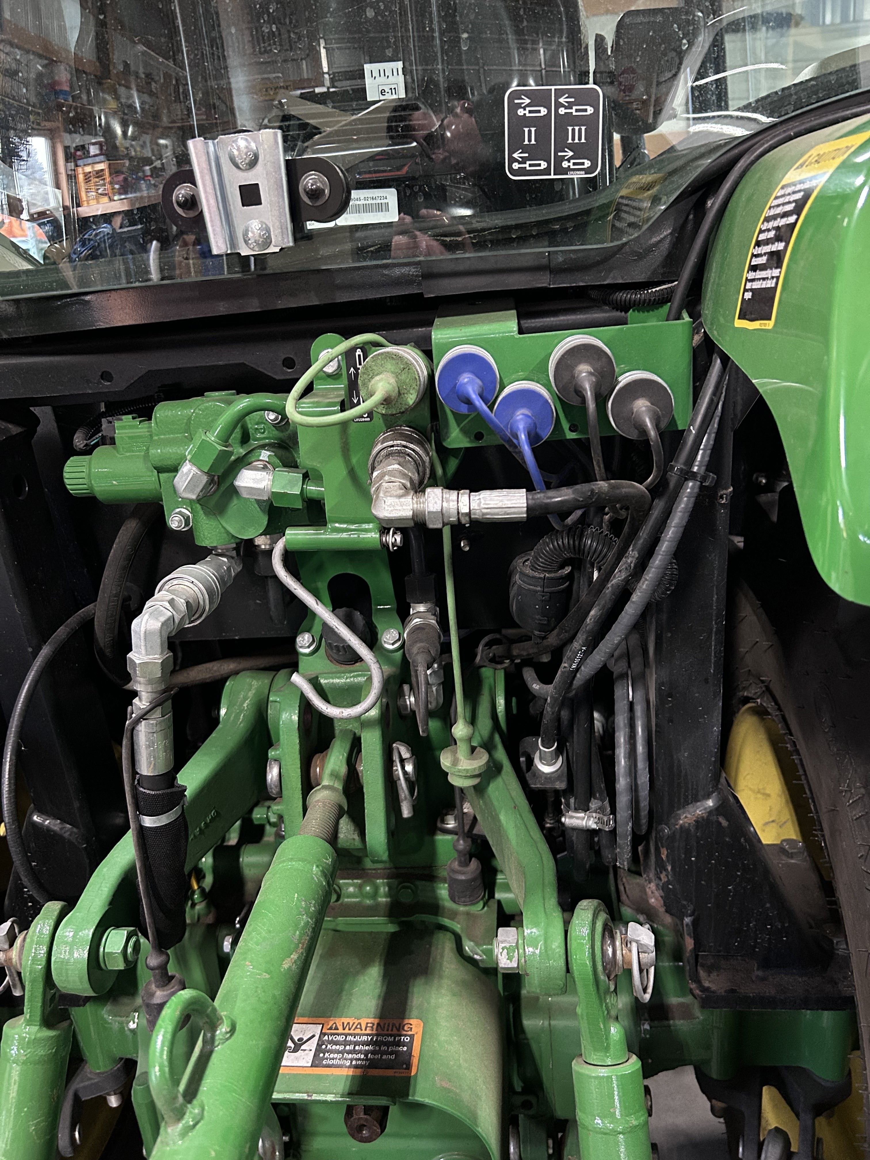

I'll answer the questions in order.
1. I am not sure which one it has, maybe you can help me identify which one.
2. It has 6 outlets and I'll attach a picture.
3. Cabbed tractor.
It would be nice to be able to use the thumb buttons for the shoot on the blower.
Edit: Now looking at the pictures and putting my thinking cap on. Would I disconnect the line coming from the green cap, and plug my blower shoot into that for the thumb buttons on the joystick?

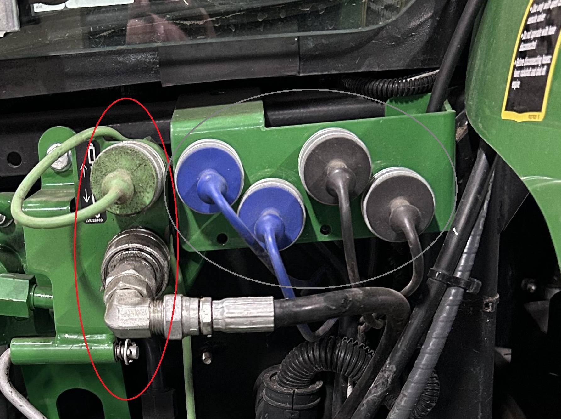

-The two couplers circled in RED are the 3rd SCV controlled by the two buttons on the joystick. You can unplug the hose for the MMM and use it for a grapple, the chute on the snow blower, a hydraulic top link, ectc
-The two circled in YELLOW are the 4th/5th (Why they are labeled 2/3 I don't know). There are only active when the switch on the console is ON, they are operated by moving the joystick fore/aft or left/right. These are 'diverted' from the front loader ports.

You have 3 SCV’s (I, II & III).
Each valve has two ports. (3 valves x 2 ports / valves = 6 ports total).
Look at the pictures on the stickers. It shows the function of the respective top and bottom port.
One port is to push the connected hydraulic cylinder out, one pushes the cylinder in. You can follow the hoses to the cylinder. (The hose that connects to the cylinder at the rod end, retracts the cylinder). Follow the connections as shown on the stickers so that the control levers do what is expected, and not opposite.
It looks like SCV #3 are the black ports on the right. If SCV #3 is the trigger operated SCV that you want to use, then connect snowblower chute to those two.

So is it all making sense to you? The green ports are used if you want to control the snowblower shoot rotation with the electric thumb switch on the the joystick. The mower only uses one as it is a single acting cylinder (pushes fluid into the line and drains it back through the sane line) not your typical push pull as with a double acting cylinder that requires 2 lines (in and out)
Now if you have hydraulic shoot rotation and hydraulic shoot deflector you can use the blue and the black ports. You would have to flip the switch on the console on and the joystick it self would control shoot rotation by moving the joystick right and left and the shoot deflection by moving the joystick forward or backward. While the switch is on you have no control of the front end loader (the fuctions are diverted to the rear 4 ports) as Kenny said. Flip the switch off and the front end loader works as usual and the snowblower has no control.
