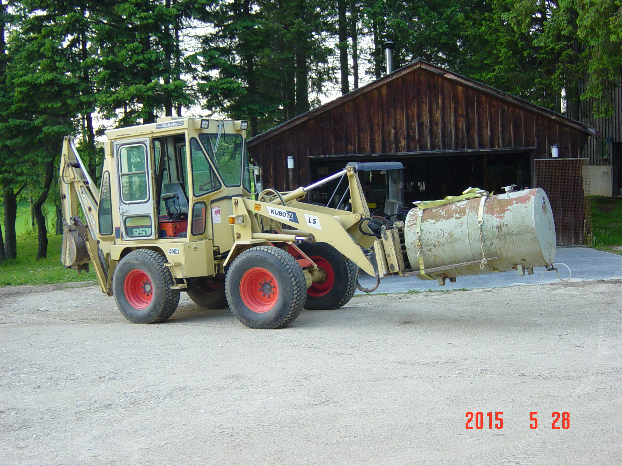

I always found good HD straps worked well along with forks.
Someone had given me a full tank of old diesel. I was more worried about having it on my truck not probably being allowed to carry that much fuel.

Can you tip the barrel over so that it can lie across the width of the truck bed? If so, drive the tractor up to the truck bed, with the lip of the bucket level with the truck bed, and the front of the bucket (which is now the bottom) horizontal. In other words the bucket becomes an extension of the truck bed. Roll the barrel into the bucket, curl the bucket a bit to hold the barrel in place.
If you can't tip it, you might need to use the same idea but with having to man-handle the vertical barrel into the bucket.
