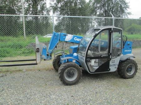

I'm looking at buying 17 concrete road barriers which measure 2x2x6-foot I can use for future projects I have in mind. However, my tractor FEL will not lift the weight and my trailer can only handle 2 of them at a time due to their length. The best I have come up with is to rent a large backhoe with trailer, load them on the rented trailer and then drag them off the trailer with my tractor at my property. The only good thing about this is they are located only about 15 miles from my property and the low price. I can spend around $500 for the equipment rental and still feel I got a good deal. They are rebar reinforced and have a loop located at center mass.
Any other suggestions?
Most of the Rental Company's around here rent the Genie GTH5519. It would be the quickest, easiest and safest way to do it.
