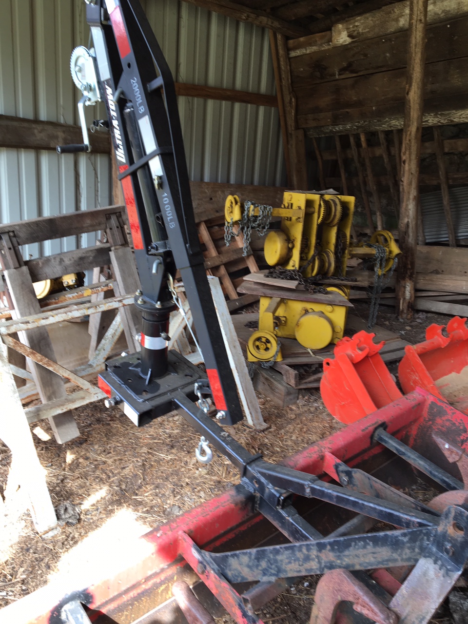

Having a hitch mounted crane has come in handy. The base allows additional jacks to stabilize. Particularly the older I get. Modified a -$200 truck crane from Northern Tool.
