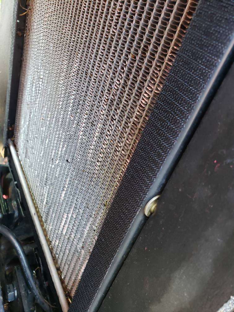

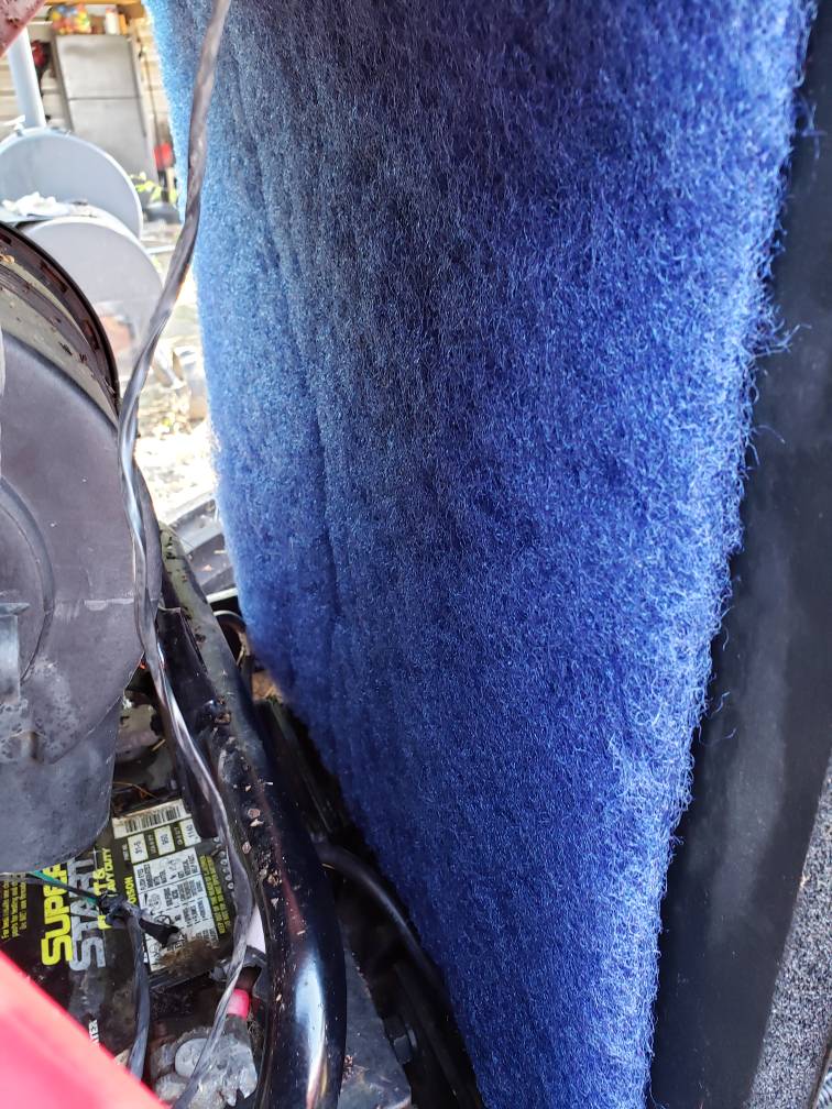

Here's what I did for mine. I used some velcro and cut to size filter material. When it gets dirty you can just remove it and shake it off. 20190902_160737.jpeg20190902_160412.jpeg

That's cool, CowboyRon. I'm also thinking about a forced hot air furnace air filter. About the right size, readily available.
