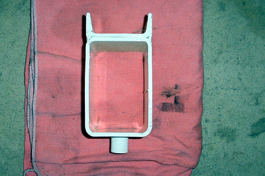

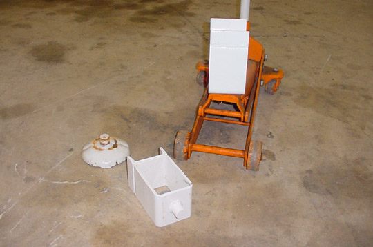

Here is what I use, fits right under axle, use per side. Philip.
