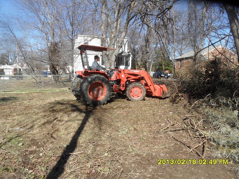

In the picture of bamboo I posted earlier we would run into a pile of the stuff, lift it, then throw a chain over it so we could drive a distance. The attached picturs show some of our lot clearing and the resultant pile. I had an area about 100x75 that was 20yr old brush, saplings, vines, thorn brush so thick as to be impassable. We cut the saplings down and then would angle the forks down slightly, ram forward and lift.
I'd still recommend you get a lightweight grapple, but for a BX25D you run out of lift capacity quickly.

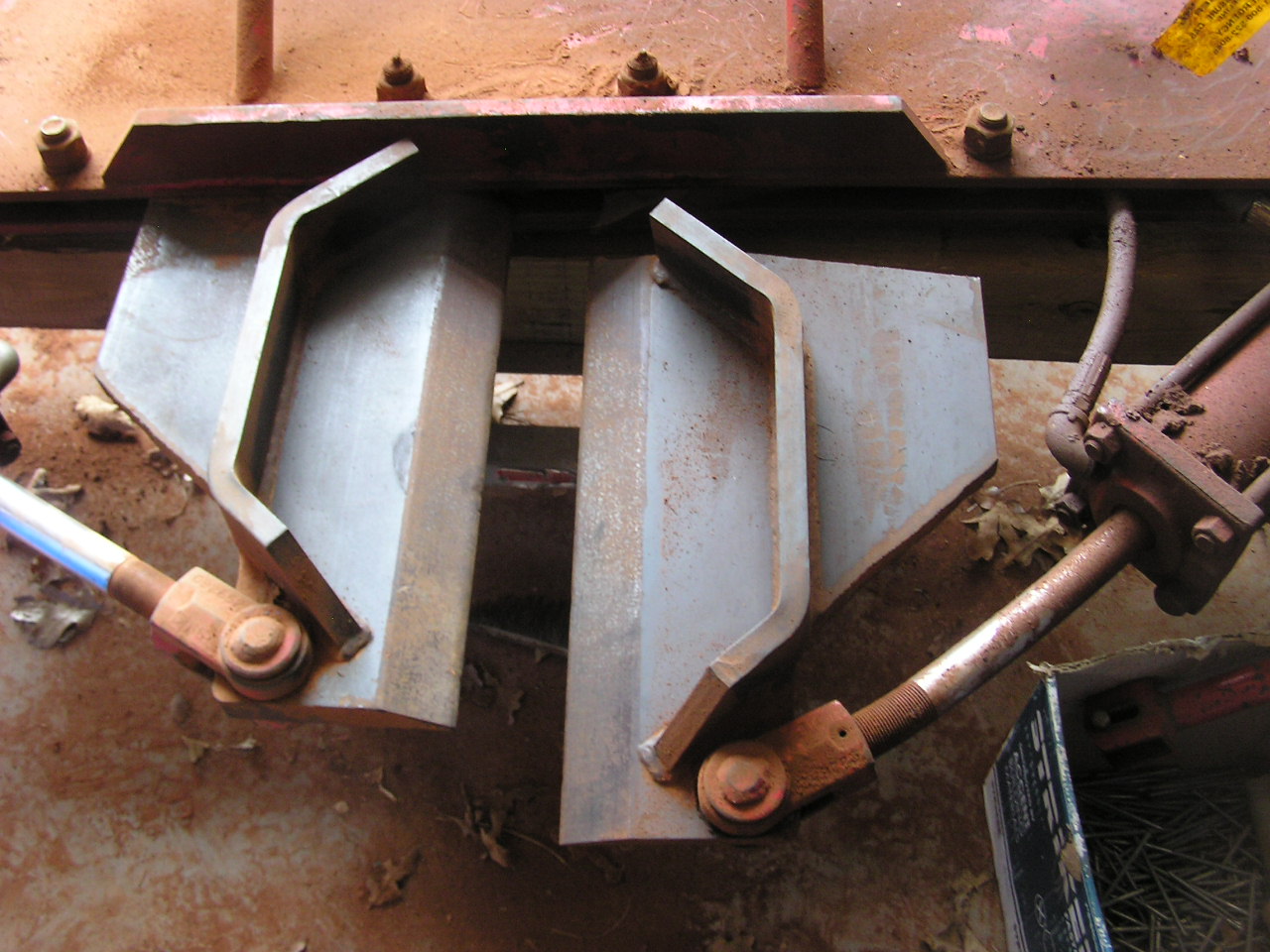

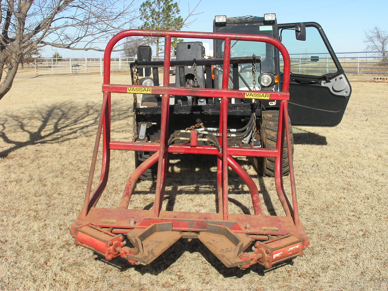

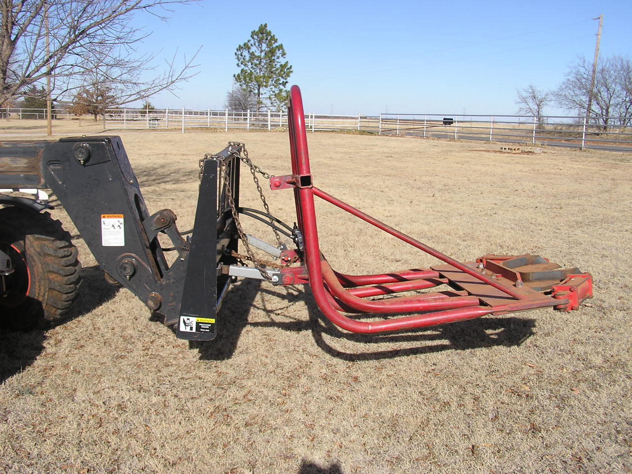

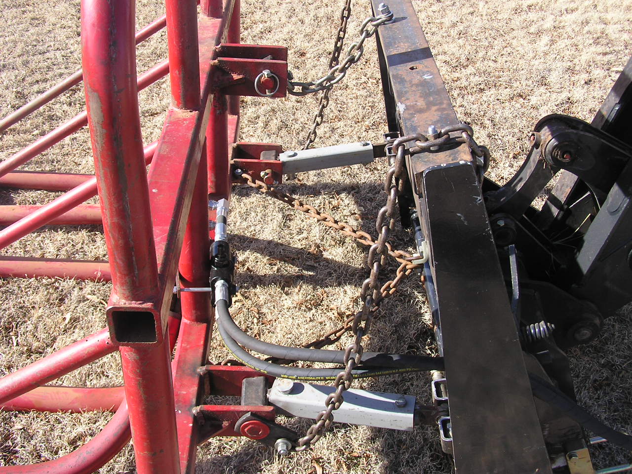

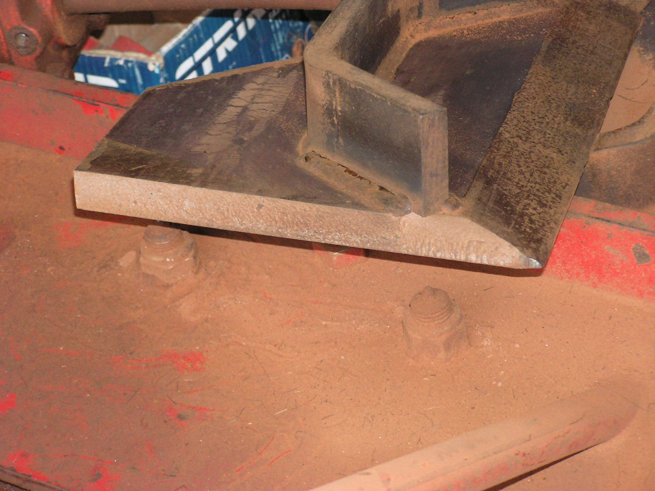

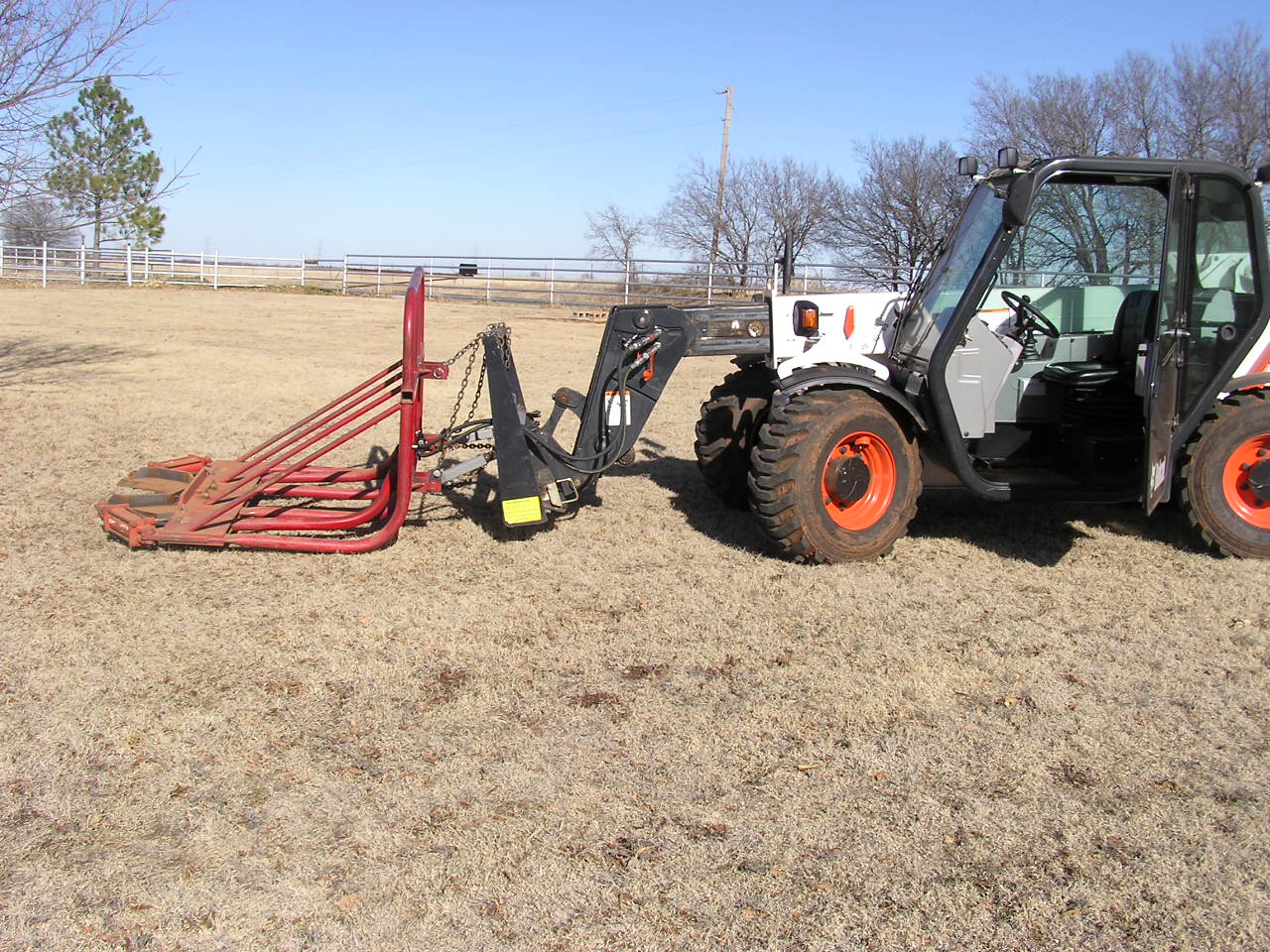

Thanks, after I sold the tractor, I modified a fork frame to use the 3 point cedar tree cutter on the V417.
So much better out front. :thumbsup:
With the chains and linkage it would set flat at the tree no matter what angle the V417 was at.

Yep, there are a few big hardwoods around here. I think the cutter was rated for 12" trees.
I was clearing the north fence line after we moved here, cutting some 10" DBH oaks, when it got in a bind and broke a blade.
Now the hardwoods that I deal with are dead, so I just pull them or push them over.

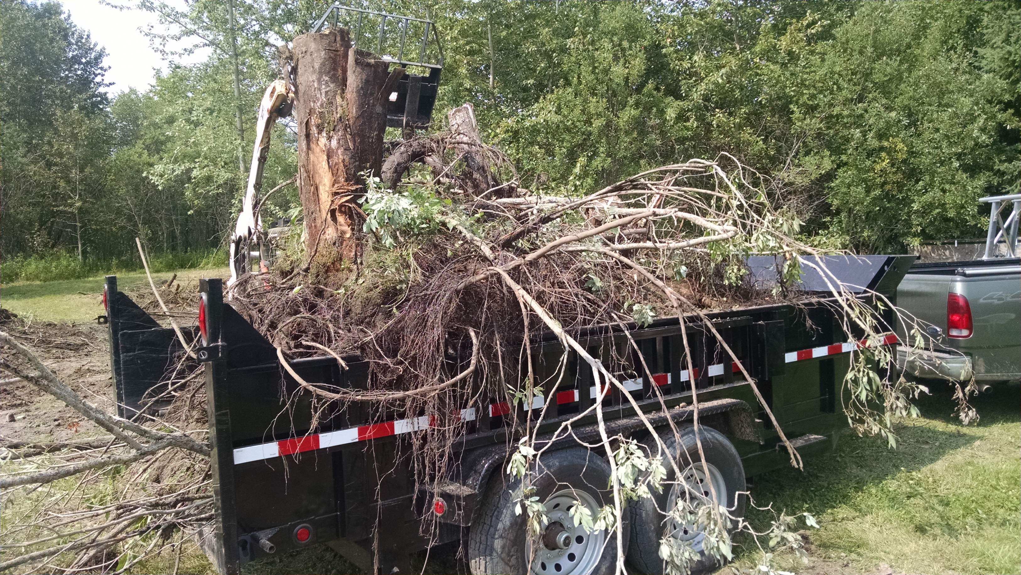

Posted the picture before, my nephews skid loader loading stump into my trailer with my pallet forks. My tractor did not have the lift capacity to lift the stump. Little 30 hp cub.

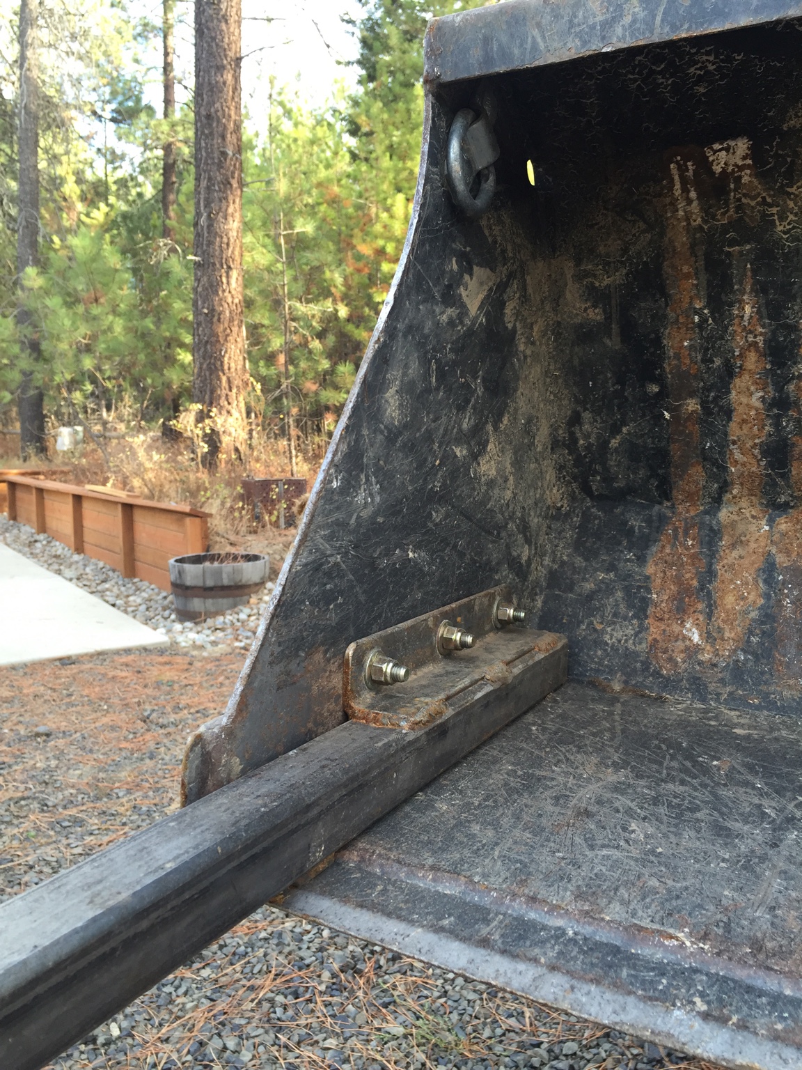

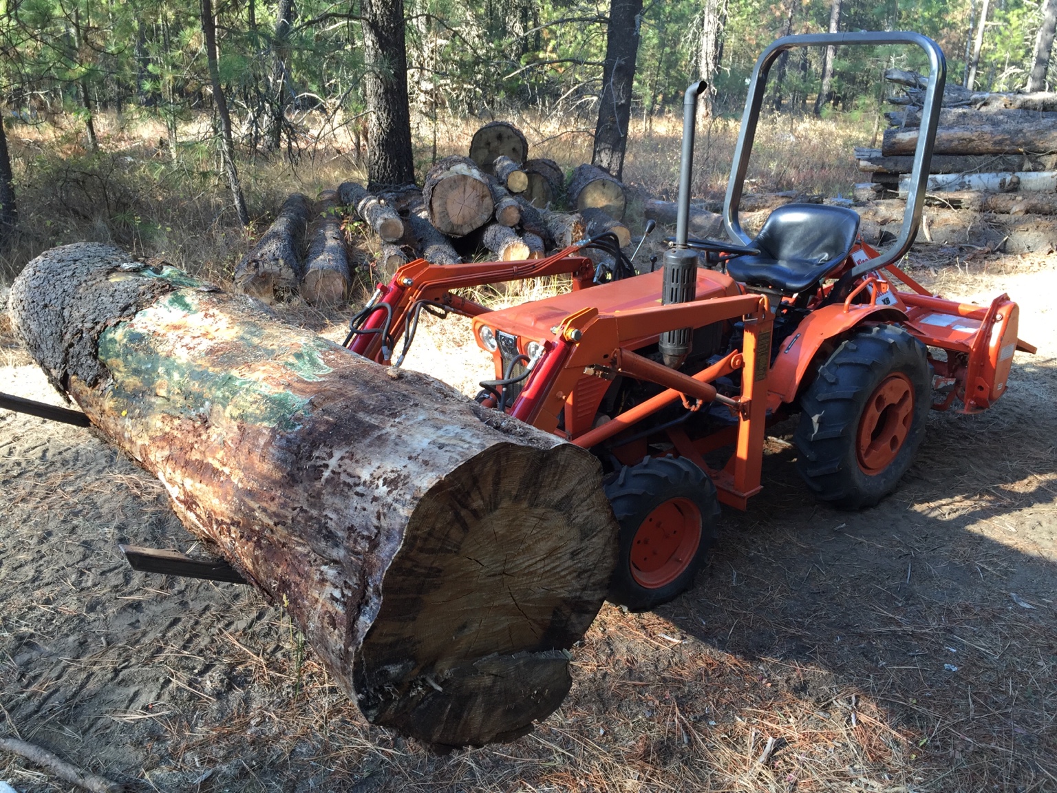

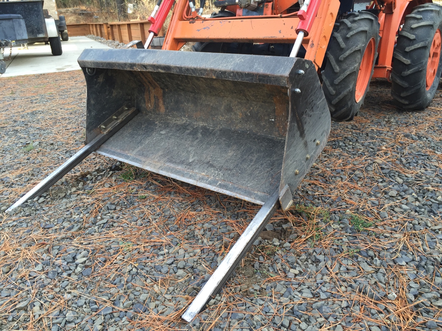

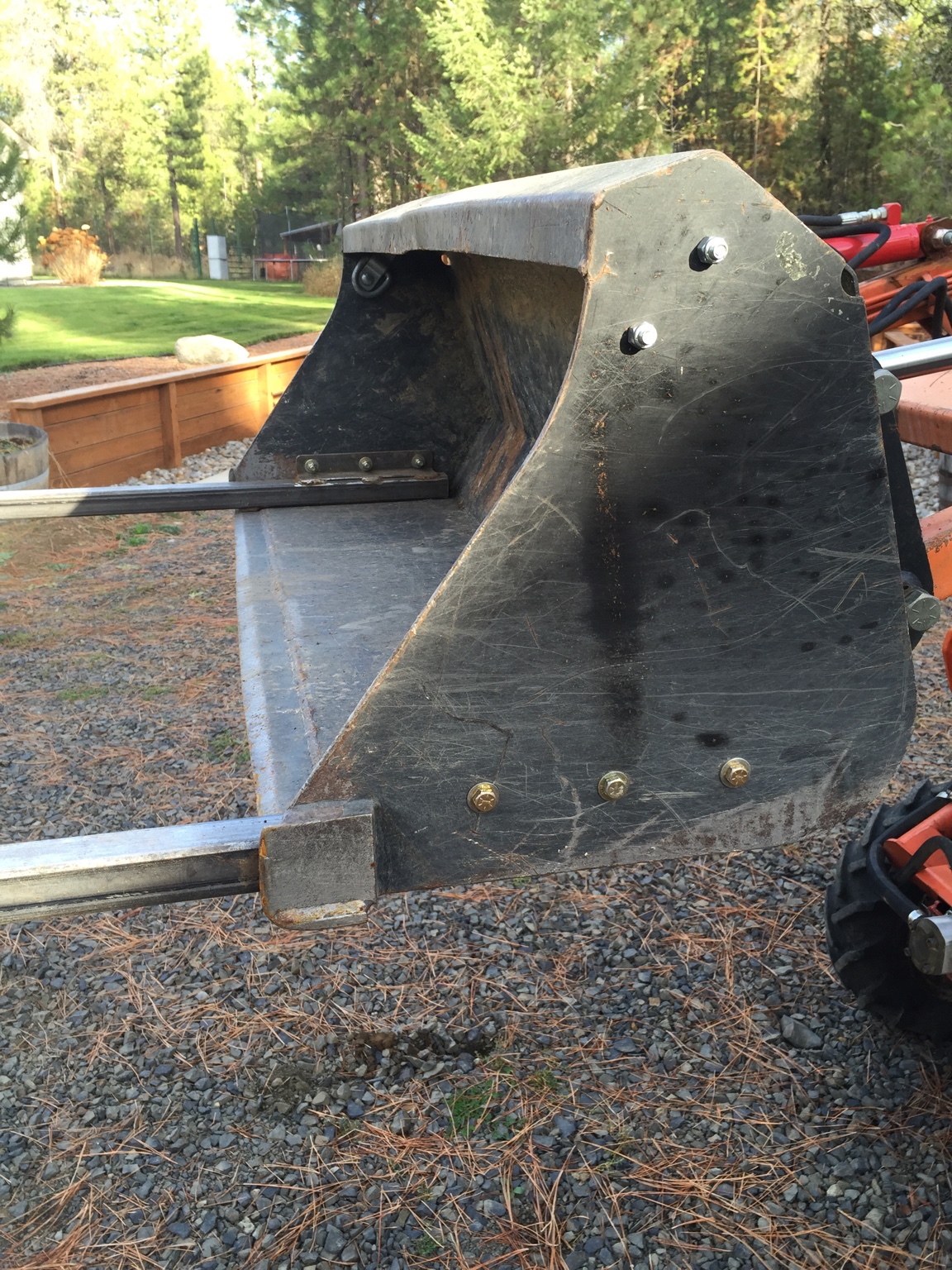

Back when I had my Kubota before I upgraded to a bigger tractor. This lil' beast could lift anything as long as there's weight on the back. Of course, I keep things simple.
I fabbed these "tusks" as I call them and they have proven their worth. They were removable so I could use the bucket.
   / How to Grapple without a Grapple - Pictures please #68
Better views...

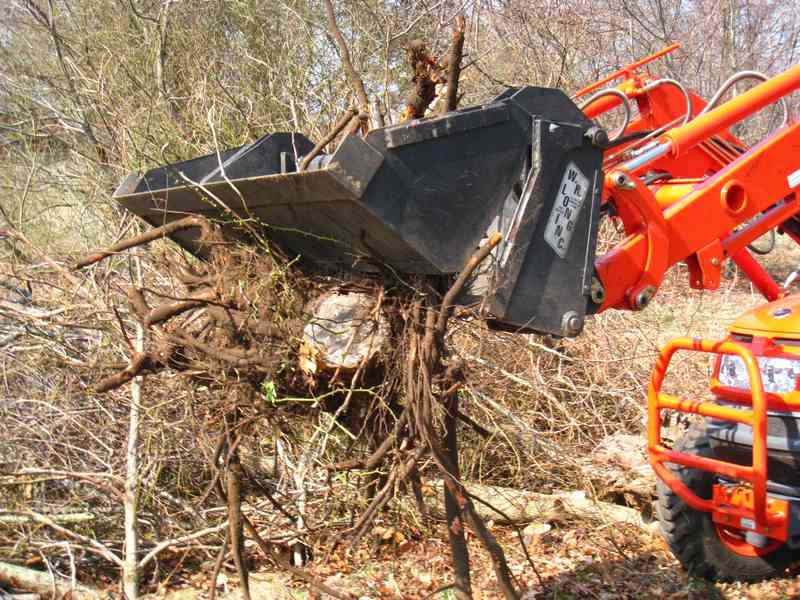

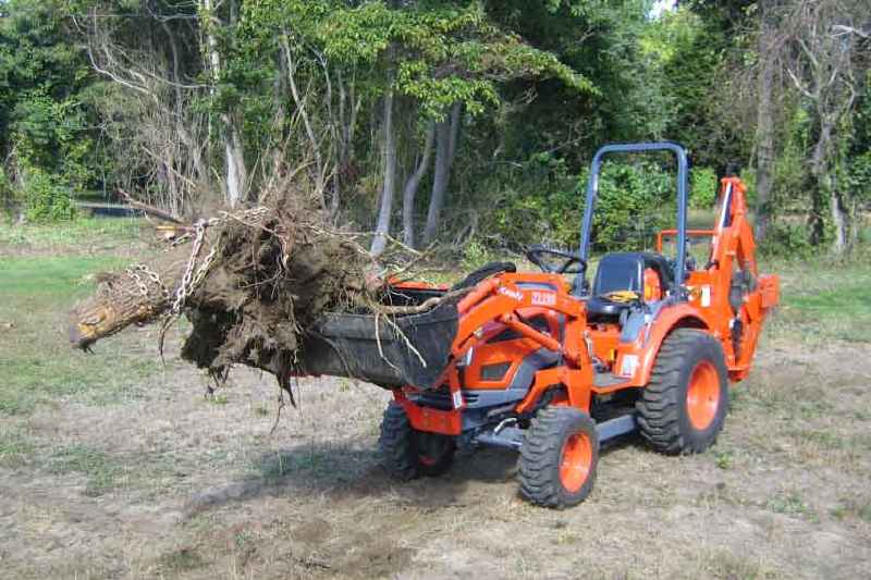

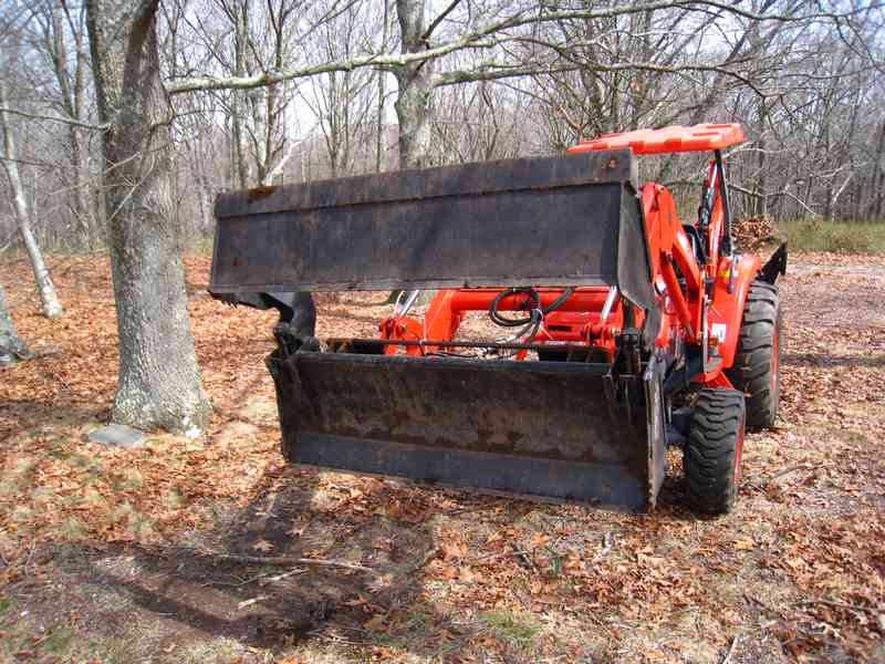

Chain and bucket.
4n1
neither comes close to the grapple however.
forks plus thumb for certain things like logs work fine (but anything with a thumb is a grapple)
