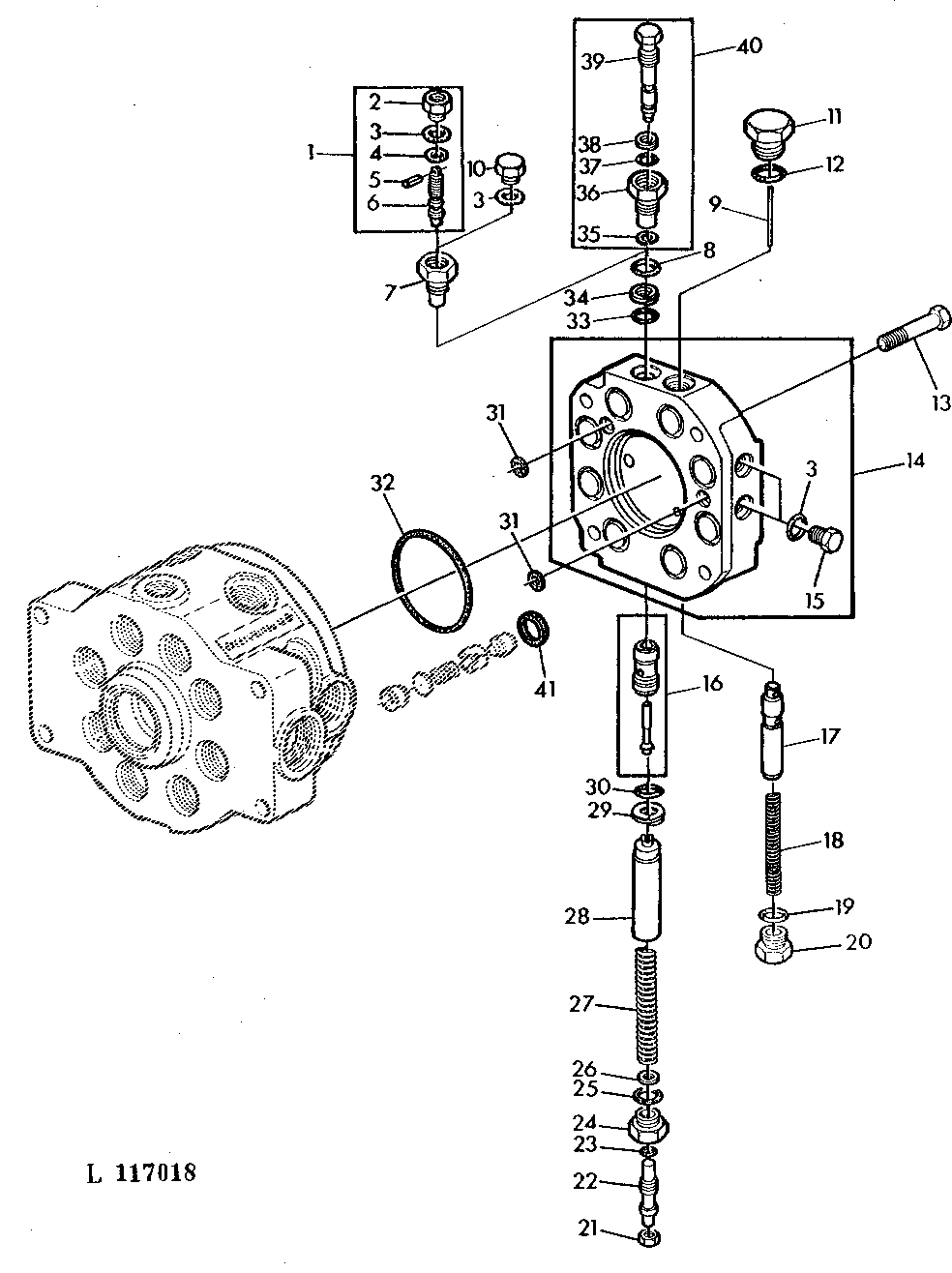

Where is the relief valve at for the pump?
   / how to flush a hydraulic system on a 2555 jd #12
It is usually close by the pump.
Do you have a manual for your tractor?
#13
I do not possess a manual.
What am I looking for at the value? I am new to hydraulics on john deeres. Its not like the old internationals.
   / how to flush a hydraulic system on a 2555 jd #14
Before you jump into the relief valve, you need to establish that the pump is actually pumping fluid.
However, the relief valve is set to a certain pressure, to protect the pump. If you know it is the problem, you can take it apart inspect, and repair if necessary.
Remove a hose from the pump and place in a bucket and see if the pump is working. Only run the engine for a few seconds.
For any hyd work, a 3000 psi pressure gage is recommended. It can be placed in a tee in the IN port of the FEL valve and will display any hyd pressure developed.
3000 PSI 2.5" LF LM GAUGE
You really need a manual or access to the electronic data on your tractor.
You need to know how things work, how to trouble shoot, and repair whatever is broke.
   / how to flush a hydraulic system on a 2555 jd #15
I second what J_J stated that you need a JD tech manual. Closed center hyd's can be difficult for an experienced tech to diagnose so the INEXPERIENCED person is in for a REAL experience. 2555 has no hyd relief valve. It has a stroke control valve(parts key 16) that controls whether the pump pump oil or doesn't pump oil. The stroke control valve is located in the frt hyd pump. Stand-by pressure of the system should be 2250-2350 psi. Check to be be sure frt pump drive coupler is intact and that the pump shaft is spinning when engine is running.
