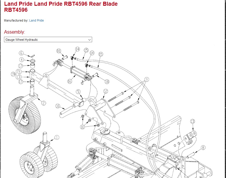

Okay there is an argument of having a gauge wheel, or having skid shoes, which MtnViewRanch recommends over a gauge wheel...
   / How to fix this road with ruts #22
Skids are good too. You could always fab up your own gauge wheel (you can buy the wheel an d caster assembly for about $60 if you look around). Laminated Tire Assy w/fork, | Grizzly 8684
   / How to fix this road with ruts #23
IMO there is no need for "training wheels" if you have a hydraulic tilt cylinder...

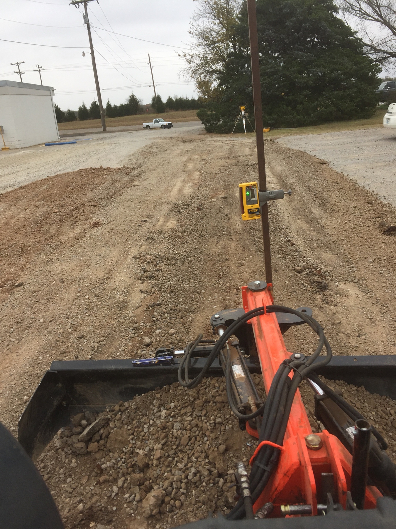

I'm gonna disagree with just about everyone. From your picture, it looks like you have great drainage. Those giving advice for creating a crown must be thinking that your road is on some flat land. Since you are dealing with a significant slope, the crown isn't going to solve the problem. Same thing with tearing up the solid base that you already have. Once tore up, it will be VERY VERY HARD to get it solid again. This is probably the worse advice possible. There is no reason to go buy a new attachment to make changes to the road that do not need to be made.
First thing that has to be done is to identify the problem. Where your tires go over your road, they are removing material. Once removed, rain will remove more material.
The material that you are using to fill the ruts isn't the correct material.
You need to find larger, crushed road base rock. It needs to be a couple inches big so rain cannot move it. It needs to have jagged edges so that the smaller material will lock it all together. Crushed concrete works pretty good for this. And the big secret for it to hold together, and compact into a solid mass is water. It takes a lot of water to do this. A really good rain will do this, but it's tricky because right after the rain, everything will be squishy, but as the water dries up, the rock will lock together.
You need to remove all that lose dirt mixed with rock fill that you have put into your ditch. Probably just wait for it to wash away the next time it rains. Then start filling the ruts with the proper material and compacting it with your tires and as much water as you can come up with.
