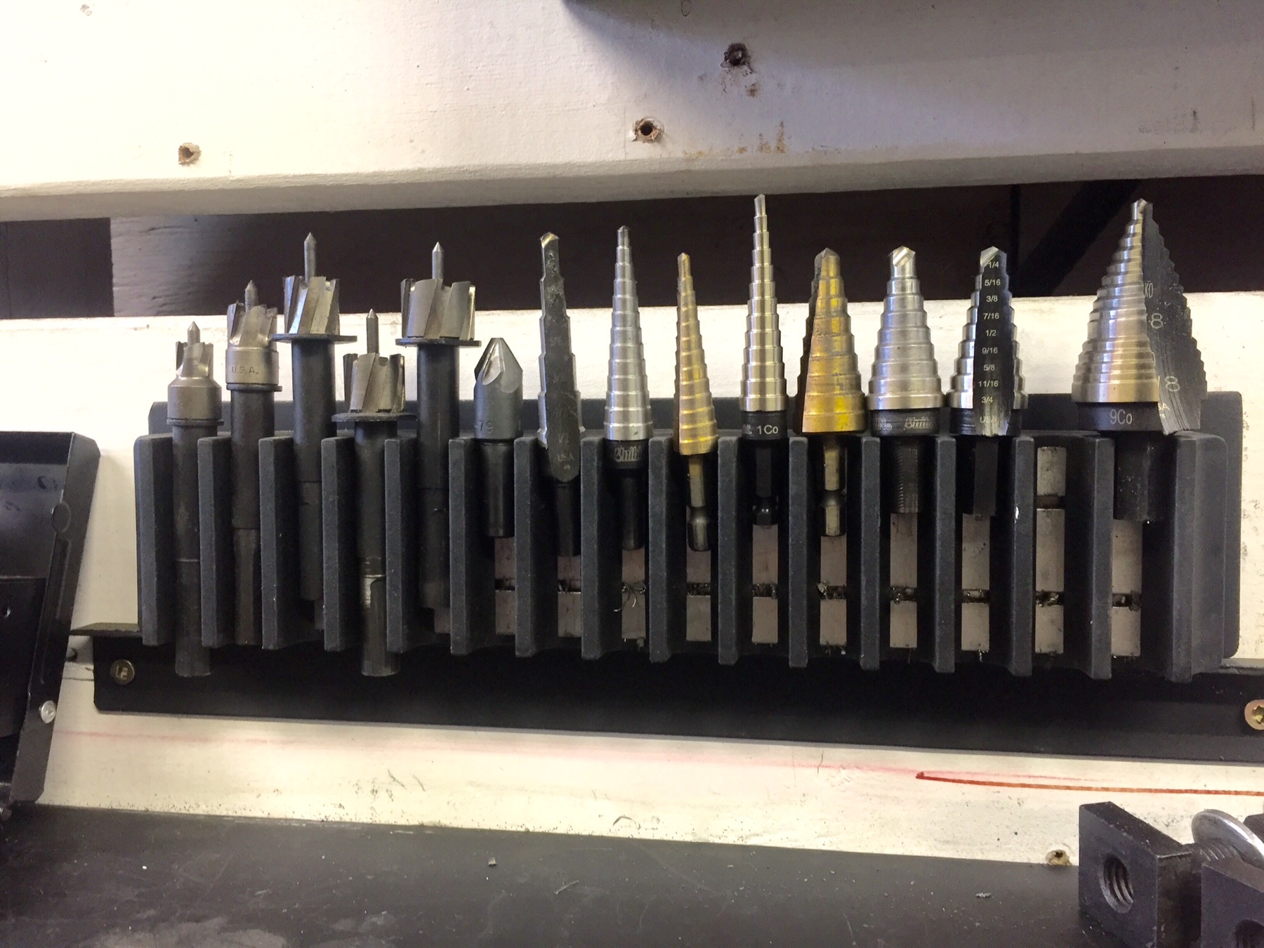

I need to drill a hole in some sheet metal...not on a tractor...but we'll pretend that it is. I have no way to tell what is behind the sheet metal on this particular machine. Probably nothing but I don't want to go shooting a drill bit through there where I don't know if there is a wire or a fuel line. Is there a better way of making a depth stop than just wrapping a big gob of tape around the bit? I'd Google it but I don't even know what to call such a device. Thanks.

What size hole? A small hole saw might do it. Or for sheet metal, maybe just grind a hole through with a Dremel carbide bit and then enlarge as needed.
   / How to drill a shallow hole in sheet metal? #6
OR.
Use a step drill. No center punch mark needed. Just drill to the first step. Check for obstructions then use the same bit to enlarge to desired size.
Terry
   / How to drill a shallow hole in sheet metal? #7
masking tape wound around the drill bit is all it takes. ;-)
   / How to drill a shallow hole in sheet metal? #8
Drill through a piece of dowel and leave just enough sticking out.
   / How to drill a shallow hole in sheet metal? #9
You must first convince the sheetmetal it wants to be drilled :D
   / How to drill a shallow hole in sheet metal? #10
I have used 2-pc locking collars before.
I dont trust tape. Sometimes if the drill bit grabs as its punching through, the tape dont stop it
