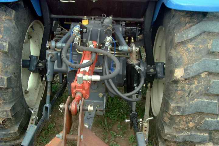

Soundguy, I'm attaching a photo to show what is involved with filling the tranny on the TC40DA that Dliston has. Notice the yellow cap in this photo. It's extremely difficult to get any funnel into this spot because the fuel tank is so close. A 2-liter bottle funnel would end up falling on the ground and make a mess. With a small decanter, you can hold the funnel with one hand and pour with the other.
On other tractors, I'm sure it's easier. It's just that on the one he asked about, a 5-gal pail is just "asking for it." /forums/images/graemlins/tongue.gif

/ How to dispense? #11
<font color="blue">Got a picture of that? </font>
I'll try to get one tomorrow.
/ How to dispense? #12
My NH 1920 had a fill cap similar to that.. I use a semi-flexible long funnel for that one. it bent around and stuck in place.. then you could prop the 5 gallon pain on yer knee and pour. But yeah.. no pop bottle funnel for that one.
