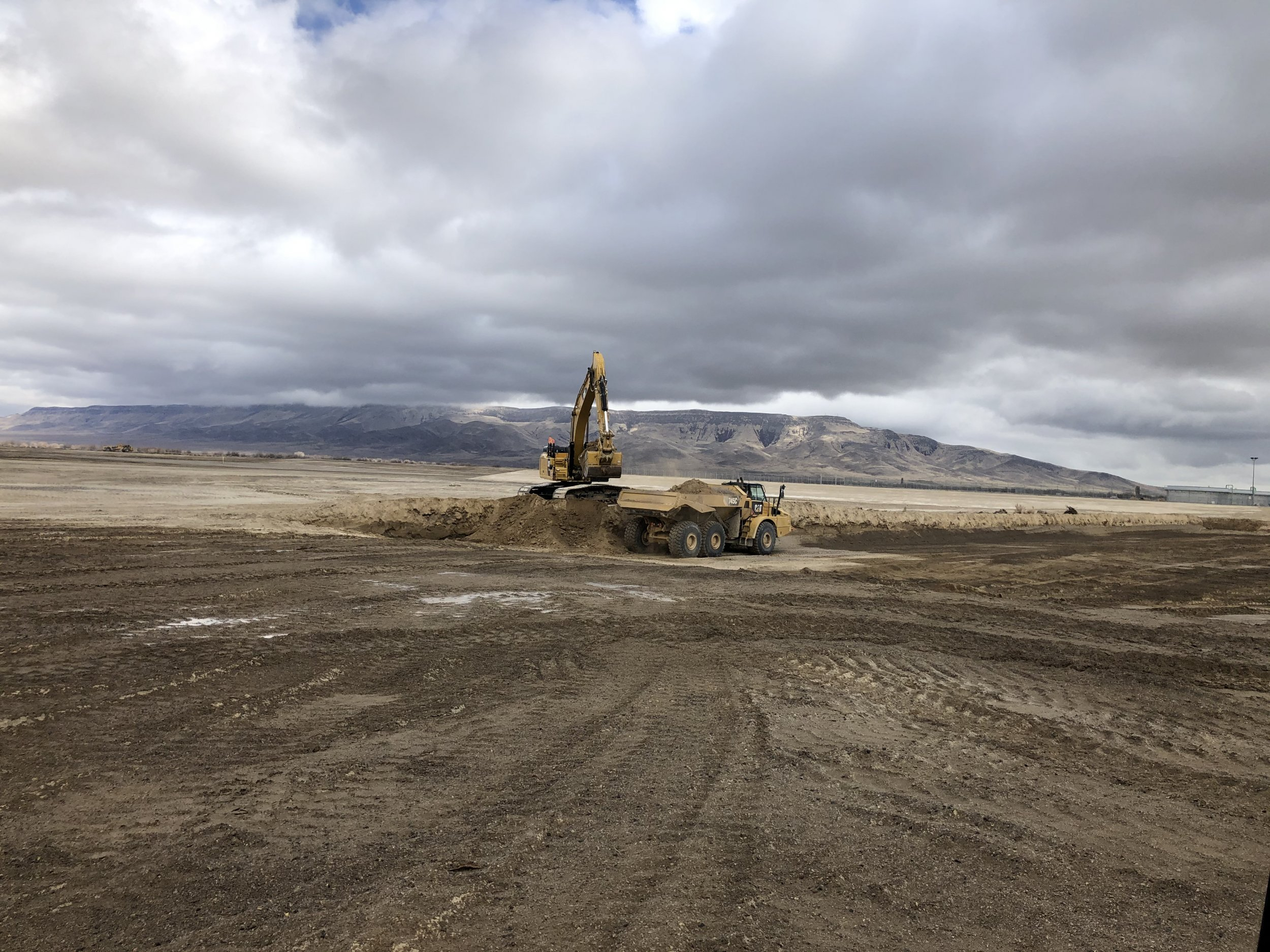

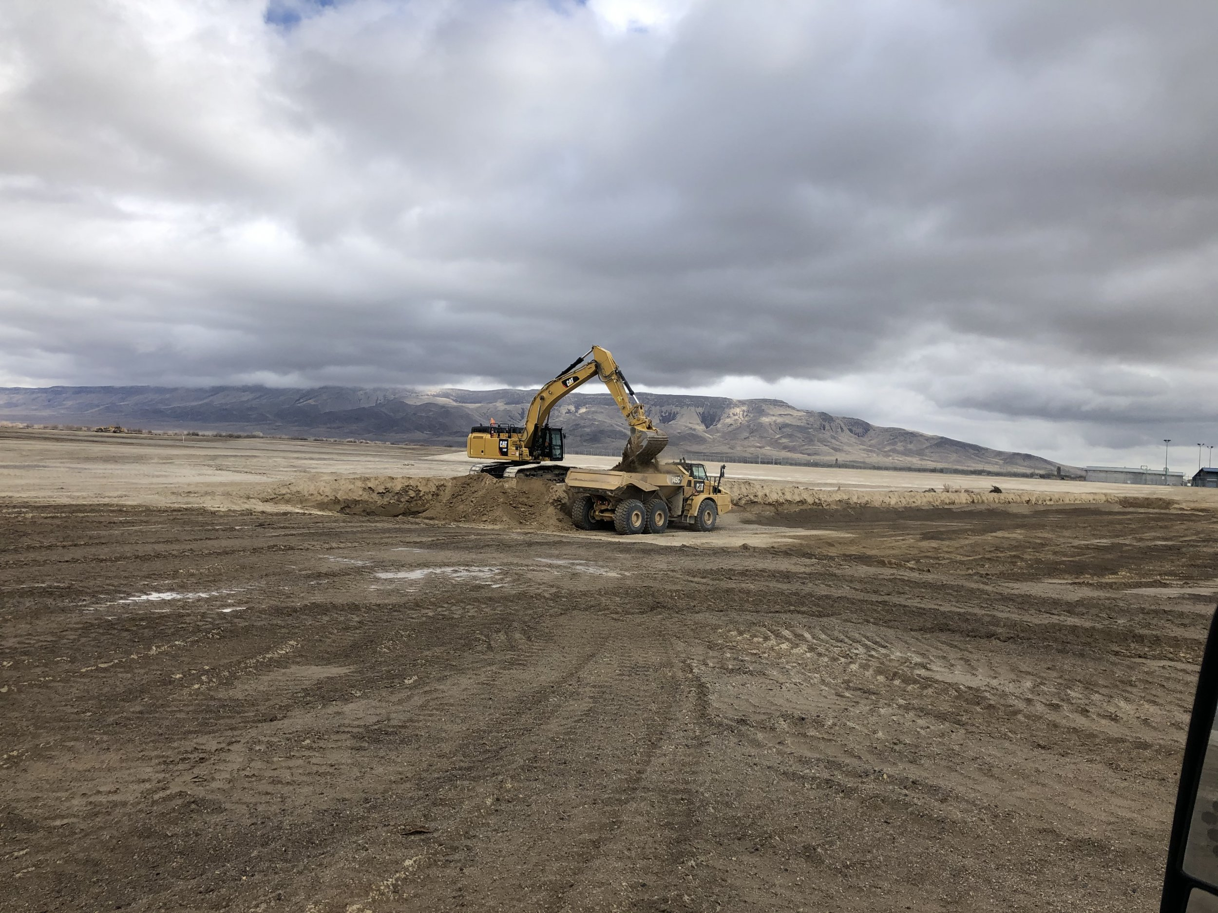

Your best production will be with the excavator on top of material and the truck lower. It may take a while to set your pit up properly you don't want to be too much higher than the truck and you need to be able to easily reach the center of the truck. Swinging across the tail gate of the truck is ideal but you can swing over the side if the situation requires it. NEVER swing over the cab. Make sure the machine is stable don't under cut yourself. Clean the floor and the toe between trucks to minimize tire cuts and damage. I think some one already mentioned to be efficient you want to keep your swing close to 90 degrees.
