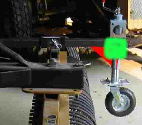

A weldable collar type jack would probably worked better in this situation.
   / How to correct a bad weld. #22
Add 2 triangular braces on each wheel as shown?
attachment.php
I'm looking at the pix and thinking that the welds holding the jacks bracket to the square tube are what broke. They have good length front to back, but not much to hold them from side stress. For some reason I don't think he welded the round tube of the jack. I'm thinking he needs to install a side gusseted plate to the top of the square tube to bolt the jack to.
   / How to correct a bad weld. #23
That's what I'm seeing.
The jack's bracket was welded on in a way it wasn't intended to be welded on when it was designed. That's why I say to add a short second tube and weld the flat side of the bracket to the sides of the tubing.

   / How to correct a bad weld. #26
Hes got a bolt on Jack. He's welded the bolt on portion to the square tube. :D
That's the weld that breaks.:eek:
The first rule of welding critique is "Look at the Pictures"
   / How to correct a bad weld. #27
Also the welded bracket is galvanized and welding that to steel is very poor fusion, generally messy looking and fails every time.
Grind clean, add gussets and should be OK.
   / How to correct a bad weld. #28
Probably chinese mystery metal, too.
You could remove the jack, weld on a bracket the same size or larger as the jack mounting plate and then bolt or weld the jack mounting plate to the bracket on all four sides.
   / How to correct a bad weld. #29
Poor photo editing on my part, but general idea would be to add a mounting bracket to the tube and then move the jack mount onto the bracket. The bracket would be on the outside edge of the tube and not the inside.
