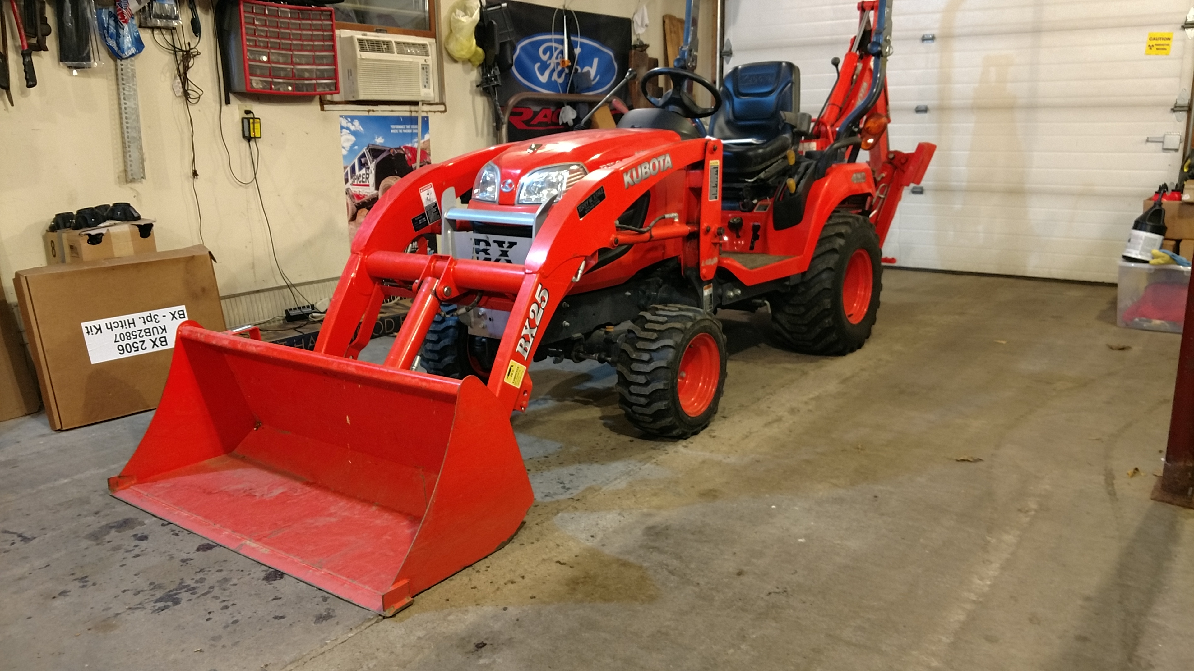

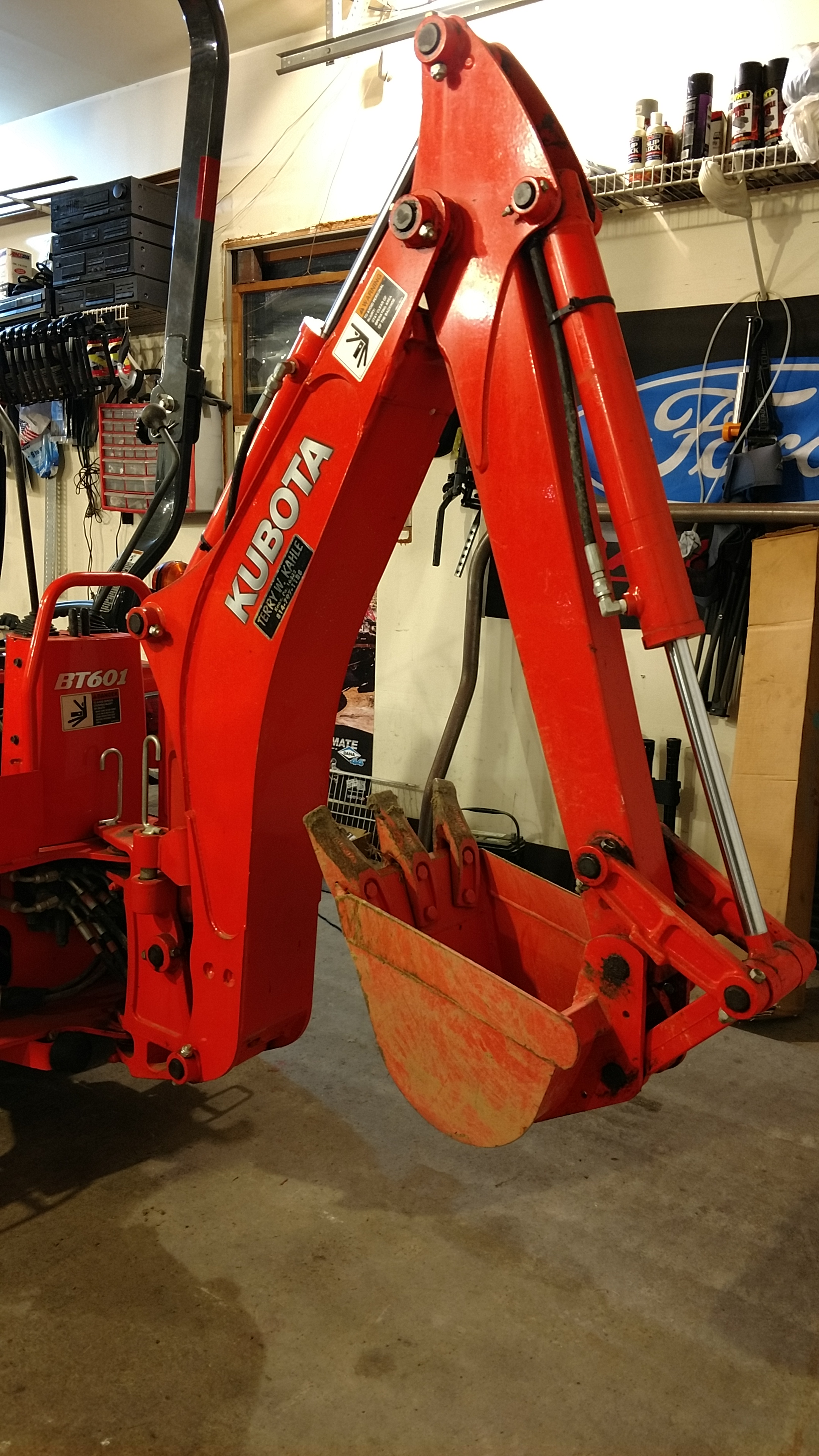

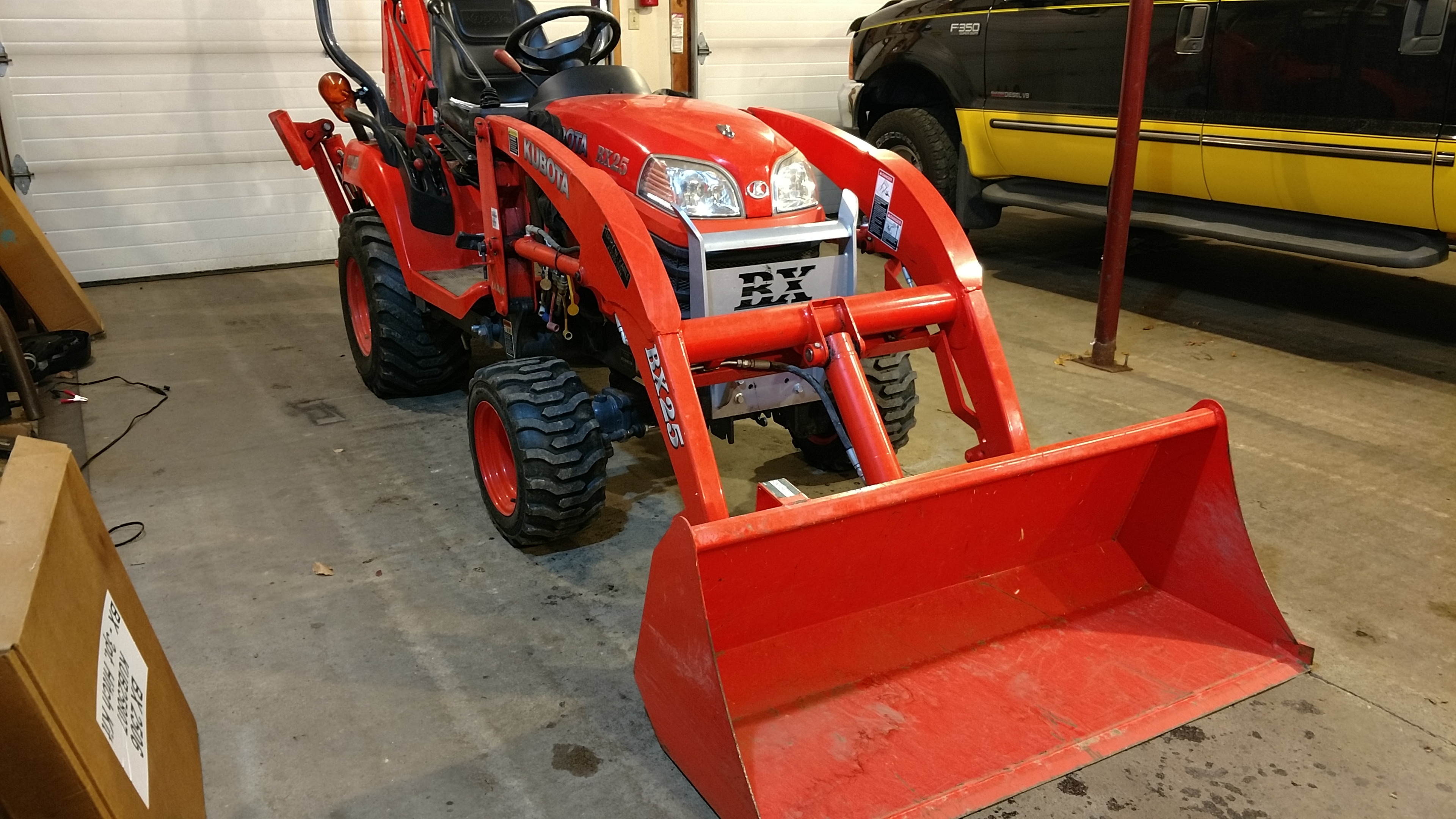

I just picked up a real cherry 2013 BX25 with 92 hours on the clock, and being an older model it has a pin on loader bucket. I would like the option of dropping a SSQA bucket and mounting up a small grapple (Everything Attachments). So what is the easiest way to do this? I do weld, plasma, grind and do the typical garage work expected of a gear head / racer / off road kind of guy, so a weld on kit is totally fine by me.
I do already know that I'll need to have a 3rd function kit added, I guess that may be a dealership job being that I know less than nothing about hydraulics on a tractor.
I saw on Amazon that I can buy a weld on kit to convert my OEM pin on bucket to a SSQA style bucket, is there a better way or is fabricating from a kit the best option?

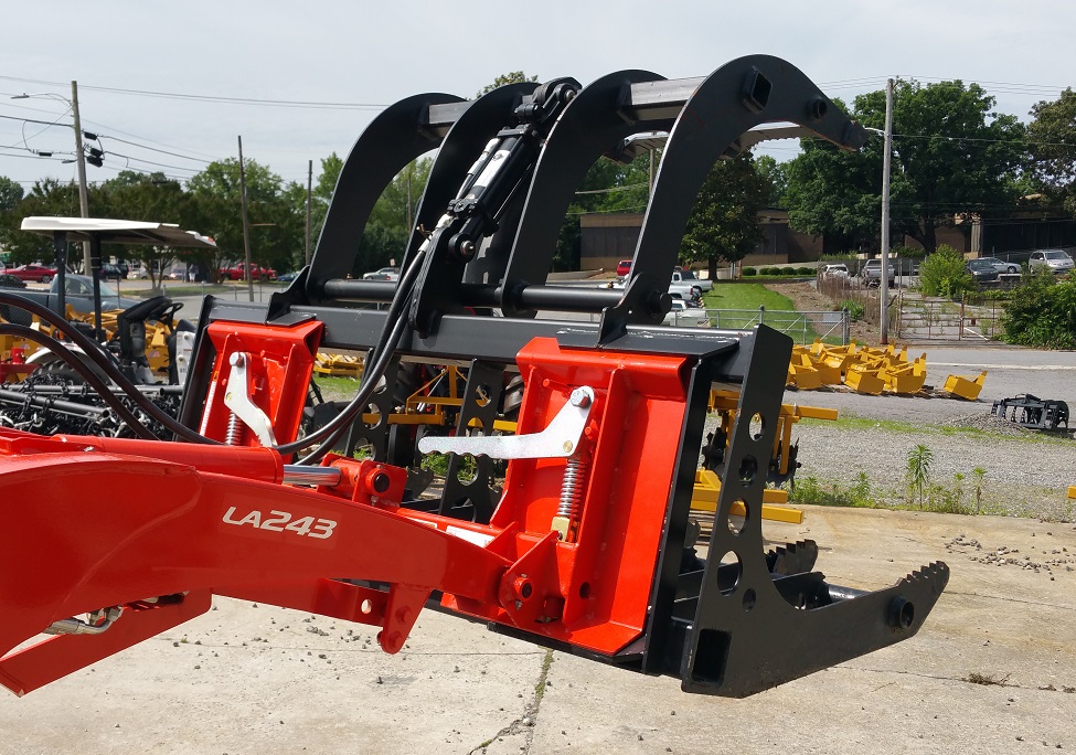

Look at MyTractorTools.com for his Tach-N-Go adapter. They are not SSQA, but work with the pin style buckets. He has forks set ups, and grapples for the BX units. Look at the weights of attachments you want to use on the FEL and the BX's lifting capacity. I have a Tach-N-Go for my BX2230 and a set of forks (that can also be used on the 3pt). Love them. No need for a grapple yet, but like the idea of them. I think others on TBN have some of the grapples.
Tach-N-Go + INNOVATIVE ATTACHMENTS
Look at his web site and call Jery. Web site not really good. He takes his time on his products, and word of mouth advertizing.
