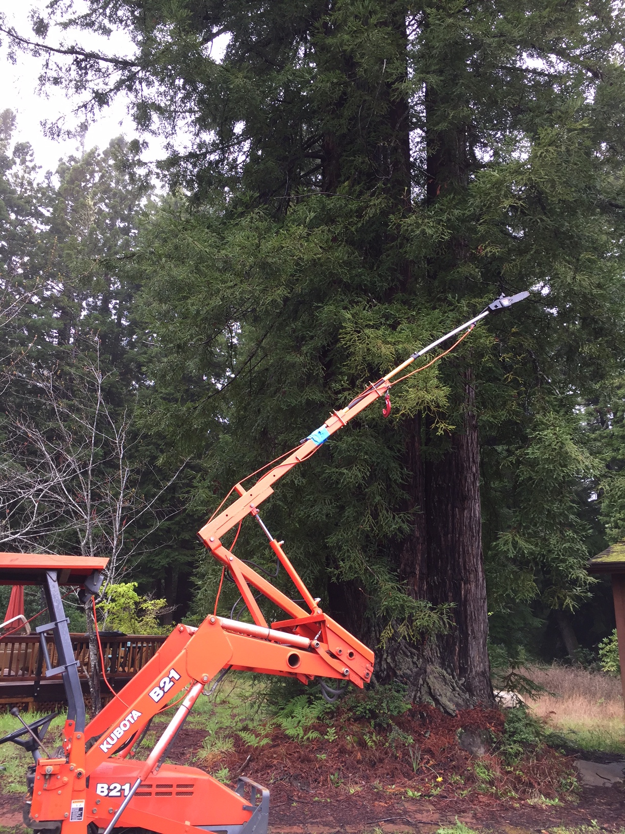

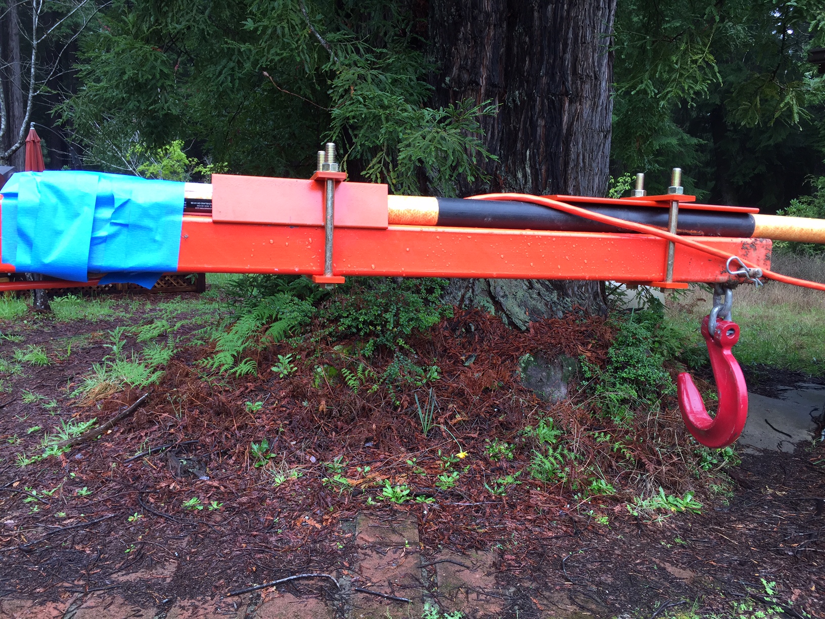

Instead of a traditional boom pole, I put my old HF engine hoist on a FEL plate. Very versatile. And a wide range of movement. For lifting stuff I put a hook on the hoist, then use straps or chains as needed. Someone made a very important point, the lift is for lifting. Not transporting. For more than a few feet, find a trailer or something rather than the tractor which will easily get too wobbly.
Very nice. :thumbsup:

Interesting saw extension 🤙

It sounds like I need a hook on the end of the pole, and after that, I can attach straps or ropes or chains or whatever.
