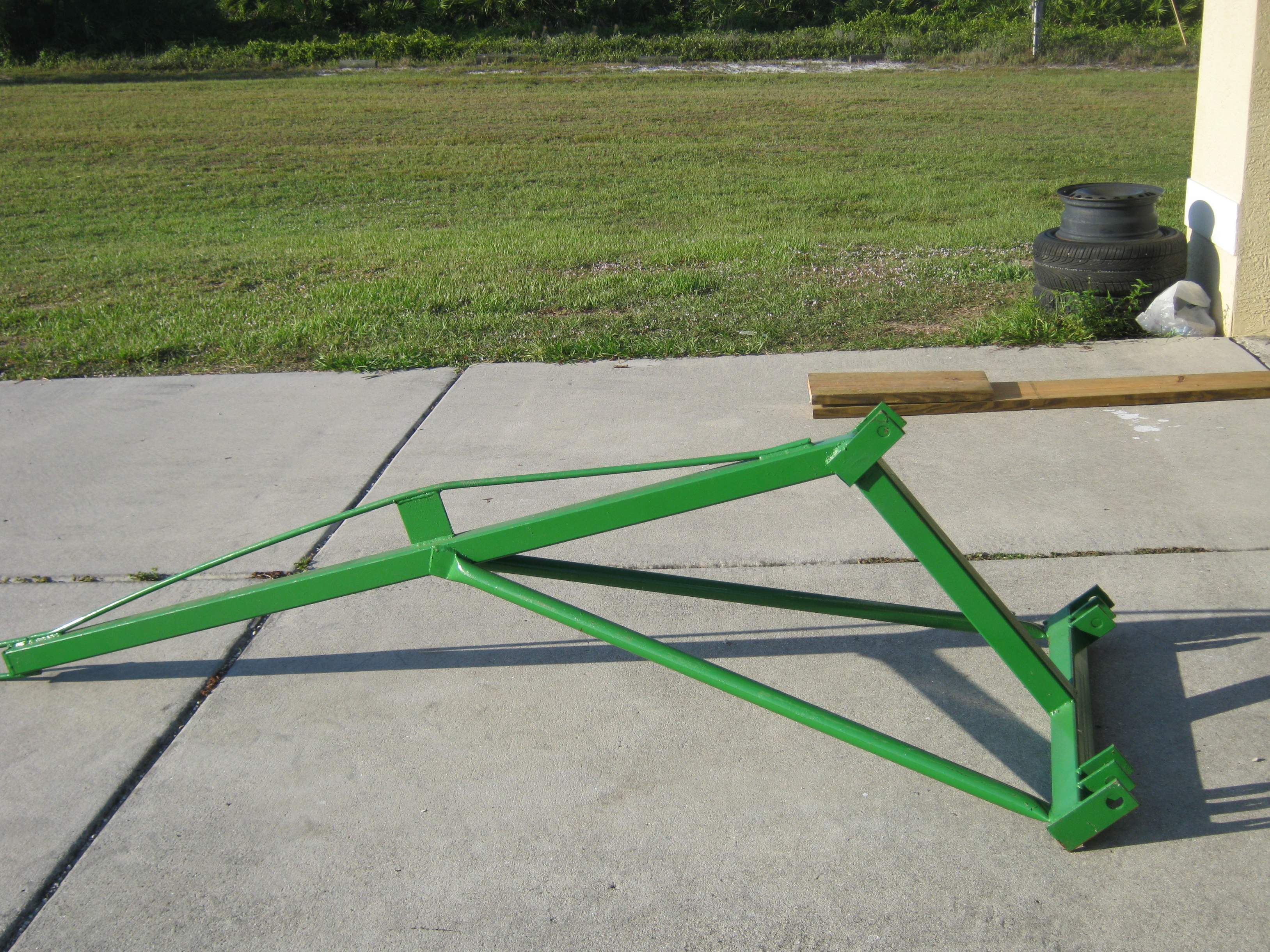

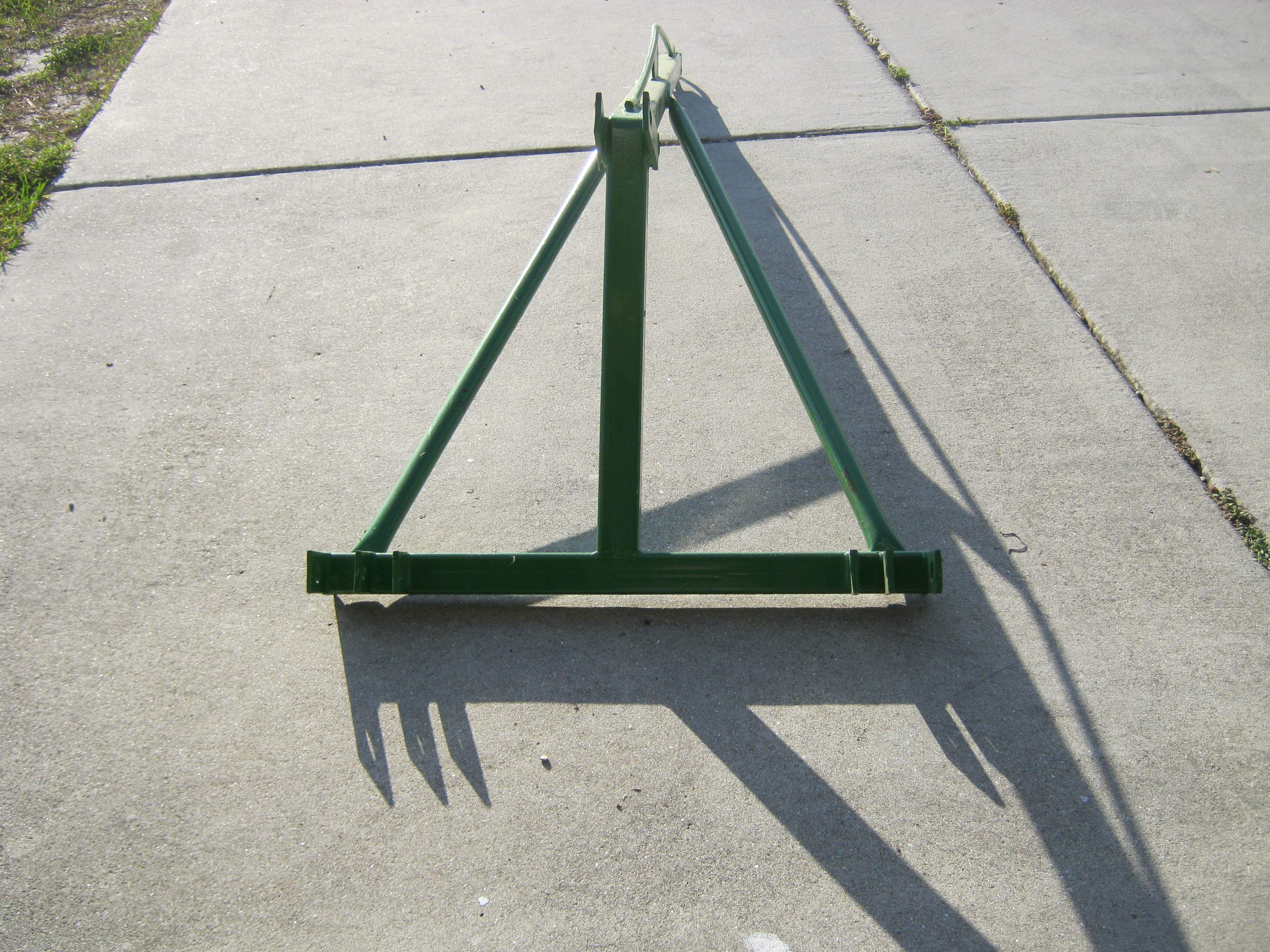

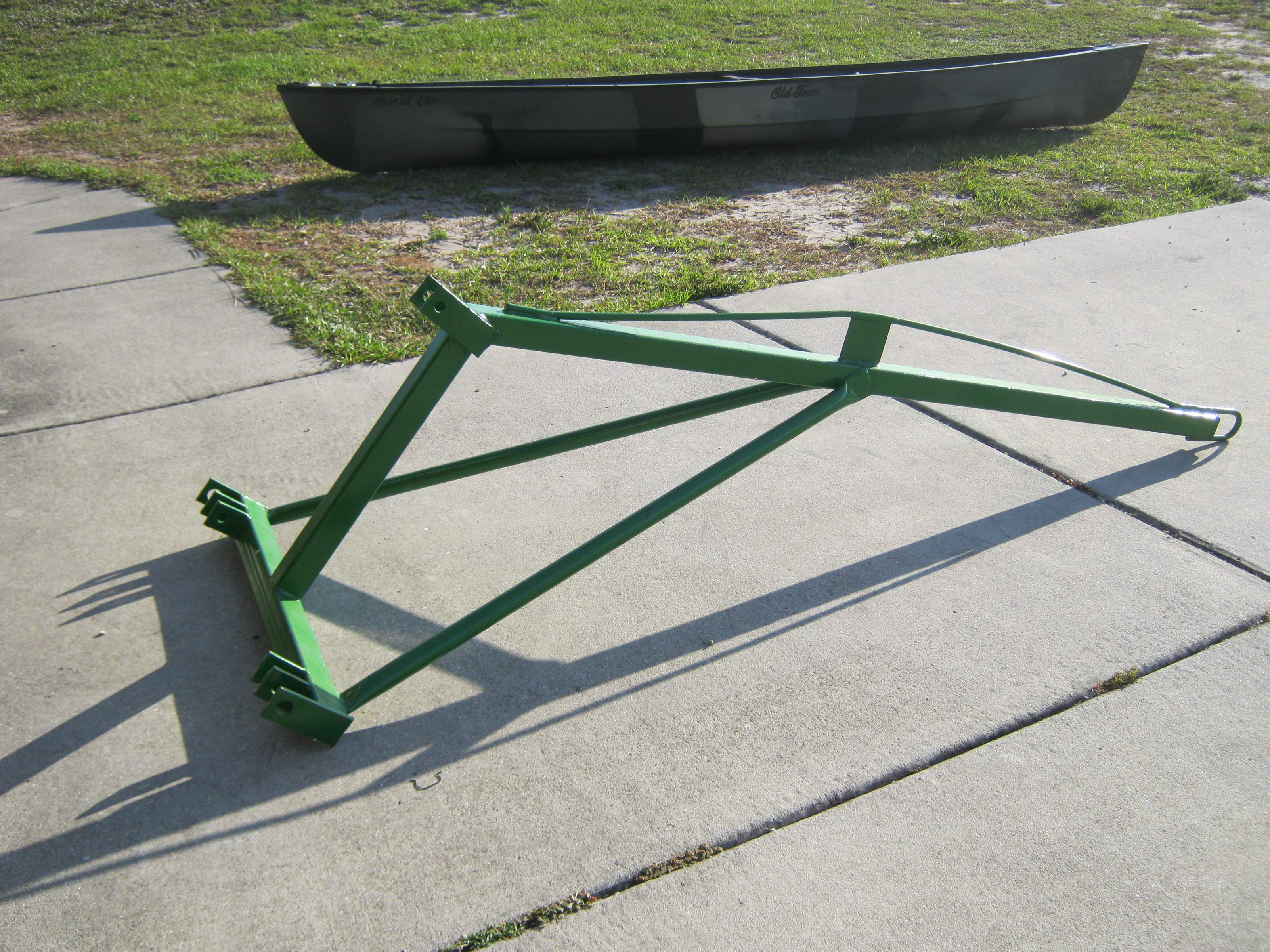

   / How to Connect Stuff to a Boom Pole? #5
   / How to Connect Stuff to a Boom Pole? #6
For other than big tractors you, better have some counter weight on the front of the tractor, you put that load way back from the rear wheels creating a lot of leverage. With my BX use my BH with the outriggers down and 500# counter weight on the front, any tractor movement the outriggers are lifted only an inch from the ground to create over tuning prevention and move like a snail. Un-level ground, beware! BPs become more dangerous as the load weight goes up.
I had a design for a boom that rotates and has its own outriggers, all hydraulic. Never got around to building it, now probably never will. I think I would prefer a front mounted boom in place of the FEL.
