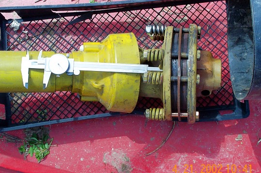

   / How to check slip clutch? #6
First, take a caliper and for a starting reference get average spring heights before any adjustment or removal…

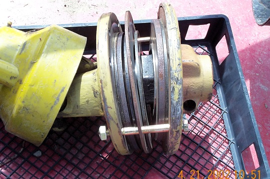

   / How to check slip clutch? #7
The method I found that works best… is to fully disassemble the unit, using a dead blow hammer to break apart any seized components, taking emery cloth and lightly taking the glaze off the clutch plates…

John,
That's seems like alot of work when you could just loosen the bolts a little, let the clutch slip to "clean" the surfaces and then just readjust and go to work ....
