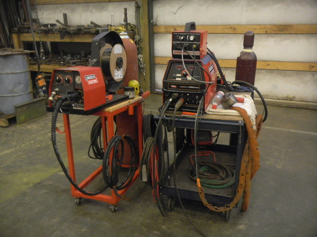

I was trying to buy a XMT-350. I never heard a bad word about them. Ended up getting a good deal on a used Lincoln V350-Pro. Fell in love with it. Bought a new V350-Pro with pulse. Sold the used V350-Pro for a $100.00 more than I paid for it.
