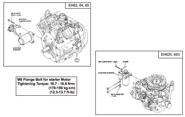

How do you check if your starter is bad or going bad?
My 1999 422 when trying to start with a fully charged battery sounds like a dying walrus. I called Robin Subaru a few weeks back about possibly putting in a bigger starter. The engineer said the engine I have, I am limited to the starter that comes with the engine.

....when trying to start with a fully charged battery sounds like a dying walrus...
I wouldn't assume the starter is bad without checking the battery and the battery cables first. Voltage ("fully charged") means little... with a weak cell, not under load, you can have a battery that is 12.5V, yet drops to 9V as soon as you try to start.
You can buy a hydrometer for about $2, which looks like an eyedropper with colored balls inside. Pull the cap off the battery, use it to suck electrolyte and make sure all the balls in the hydrometer float in each cell. The last time I was unable to start my PT422 was because the battery had a dead cell (only 1 of 4 balls floated in one cell). The unloaded voltage of the battery was 12.5V, yet it would drop to less then 9V as soon as I tried to start.
Another thing to look at is clean the battery cables going between the (+) terminal and the solenoid. Then use a piece of wire to jumper out your ignition switch to cause the starter solenoid to spin the engine. Common source of failure is dirty spade connections on your ignition switch, or an ignition switch that has arced internally and now doesn't allow enough current through to kick over the solenoid. Running a jumper wire straight from the battery to the solenoid will rule this out as the cause.
Only when I have verified the battery and interconnecting wiring would I suspect the starter or the solenoid. And usually the solenoid is the culprit before the battery.
On the older Robin engines, the solenoid (actually called a magnetic switch in this case) was separate from the starter, so you would only be out $58 instead of $250 if that is the case (assuming brush replacement didn't solve the problem).

Also completely remove the ground cable from the battery. Clean both ends and the frame or engine block where it connects.
What is the voltage on the + cable clamp at the battery and at the starter when it is turning over?
