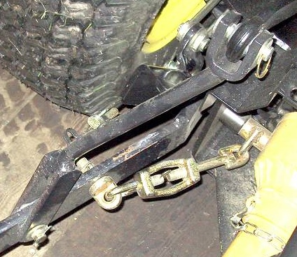

<font color="blue">...Another question - I have these adjusters on the inside of my hitch arms adjusted so they are just a little loose. Is this right? ...</font>
Usually, you’ll adjust the anti-sway links (turn-buckles) when the implement is in the UP or transport position (and centered between rears)… then slowly lower the implement back to the ground making sure you have free unrestricted movement (not binding or going into tension).
On many 3-pt hitches, if you adjust the turn-buckles in the DOWN position… and then Raise the implement, it will “tighten” going into tension and something has to give, bend or Break…
