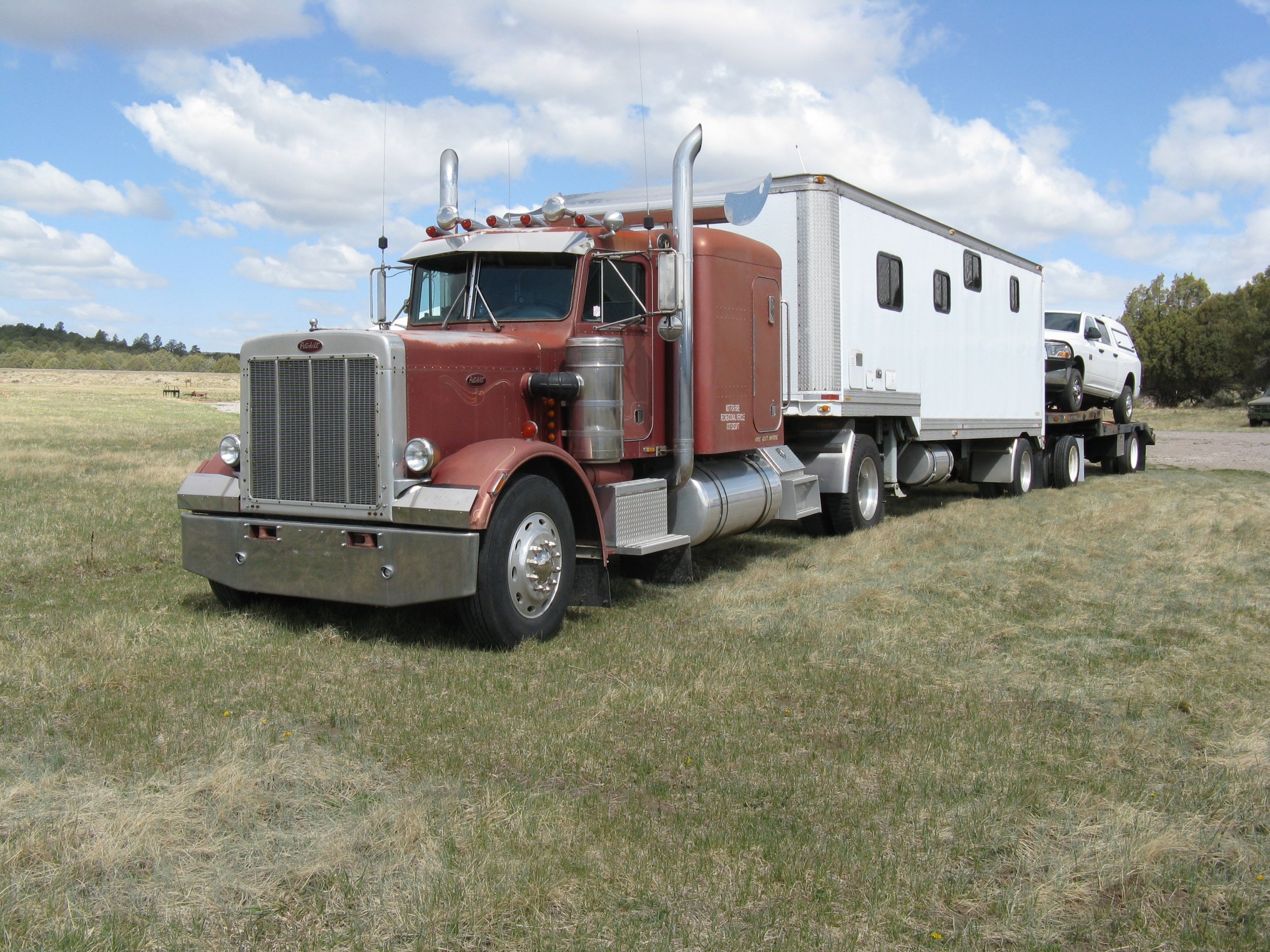

So what
Semi trailers can't be disconnected from the tow vehicle and hold up all of their weight on the wheels alone. They also don't have a tongue that steers a front axle. Those are the defining characteristics of a wagon.
So what I have hooked up behind the first trailer is a wagon?
I always thought it was a second semi trailer with a con gear, making it a full/pull trailer.
But yes, what the majority of people call trailers are actually semi trailers. And don't get me going on "semi trucks". Something that doesn't exist in real life.
   / How to back up a pivoting axle trailer #96
So what
But yes, what the majority of people call trailers are actually semi trailers. And don't get me going on "semi trucks". Something that doesn't exist in real life.View attachment 850663
No. The front "axle" (con gear) isn't part of the rear trailer any more than the truck is part of the first trailer. But I see where the confusion could arise.
