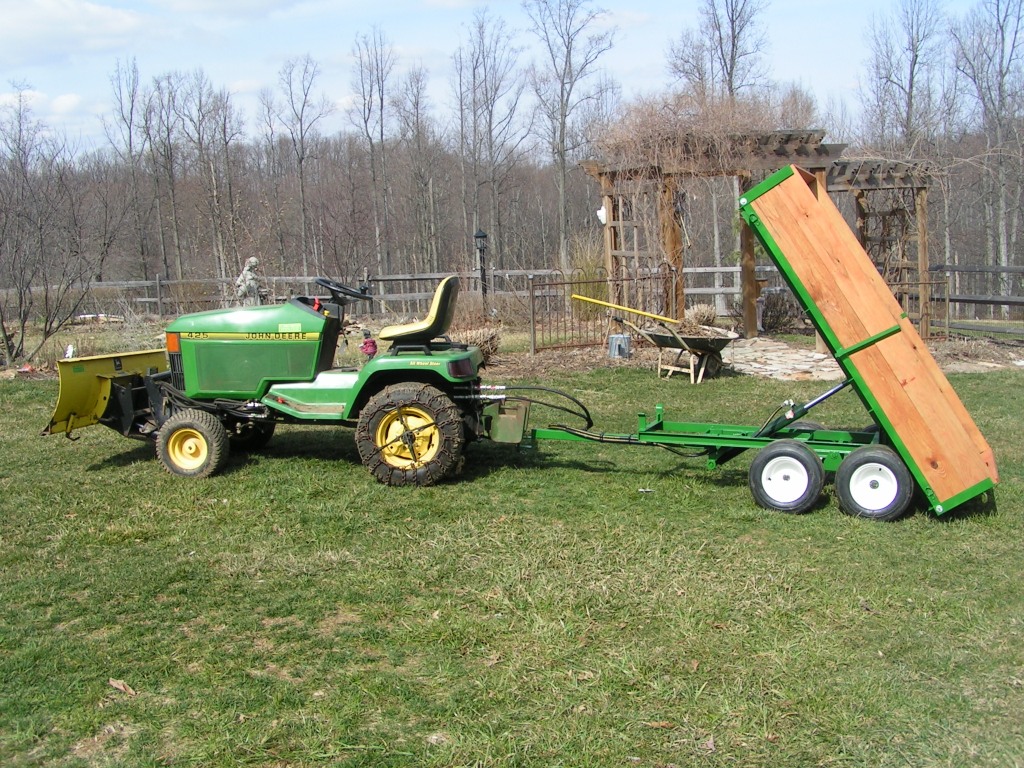

Plumb it from the loader curl ports and use the loader curl control to control your rear remote. I use the left/right ports on my patch panel to the remotes I added to the rear of my JD.
