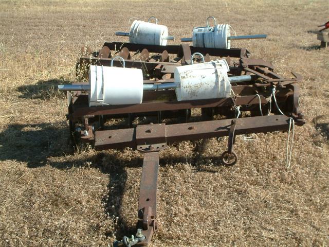

   / How to add Ballast with 3pt in use? #24
I made a few concrete weights (~120 lb each) for my offset disc. You might be able to chain two of these to the lower arms of the 3pt hitch and get more ballast weight
The handle and the long piece of chain link fence post make it easier to muscle these weights around.
Your $10 solution:D
Good luck.
