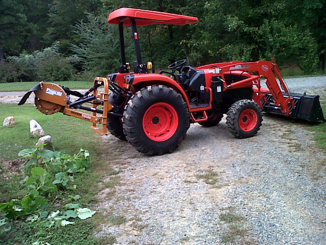

The logical configuration for my tractor almost ALL of the time is stump-grinder on the 3-pt, and Grapple on the FEL.
So the other day I learned for sure the 3pt is not enough ballast, I was knocking dirt off a pine stump and bouncing the rear wheels.
So... How can I add more ballast when the 3pt is in use?

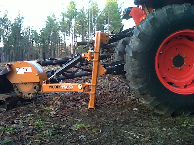

Pics enclosed. TSG-50 only weighs 545 lbs. Tires are fully filled by my dealer. I have yet to fail to lift anything I have tried to lift. I have not tried to lift an immovable object. One time I lifted two 30-40' green pine logs (recently fallen, tops and root balls removed) and the rear felt VERY light and low traction.
I was not aware you can "bounce" the tractor just with the FEL even if you are not near load capacity. Seems logical though...

The QH will move the load rearward also, making it a little 'heavier".
But looking at your picture, the stump grinder is not enough ballast for your tractors FEL's capacity. You need considerably more. Rear tires should not be bouncing before the loader hits relief.
JB
