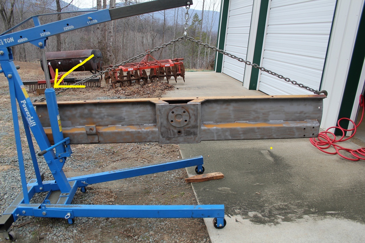

So I got one of those 40 Lb. pressurized abrasive blasters from Harbor Freight to restore a number of implements. I have never used a sandblaster before, but it seems to work quite well (I got a 7.5HP 24 CFM compressor behind it). I'm using Black Diamond fine media (20-40 I think) from Tractor Supply.
I plan to prime and repaint my implements after removing all the rust. My question is how thorough I need to be in stripping the old paint before proceeding to the prime stage?
I'm working on a Woods RB850 blade first. Here are a couple of shots of the pieces after taking it apart:
Car dolleys are handy for moving these heavy pieces around!
I started with the blade itself, and here's what it looked like after working on one side of it. (the blasted areas on the other side is where the labels were)
And a little while later:
Should I keep going until the entire surface is completely smooth (as can be seen in the areas where there were labels), or will leaving it like this be good enough? (I do plan to hit those areas that still have solid paint). What I've done so far consumed 1 50lbs bag.

i would be very careful about sandblasting close to hydraulic cylinders... or am i being overly cautious?

That's a good point. When I lowered the cylinder to re-position the blade, I head crunchy sounds. I stopped right away and cleaned the rod and blew off the sand from around the seal. Seems to be ok still. Nevertheless, I'll likely put the pieces on blocks from now on and only use the engine hoist to transport the pieces in and out of the shop.
your being overly cautious. There is no possible way your gonna hurt that cylinder on the engine lift. You would have to be intentionally spraying at it directly but even so, you would have to be shooting it at one spot for awhile. I have one of those lifts that i have removed and installed about 10 engines and the thing has been smacked by everything in the book and still going strong.
