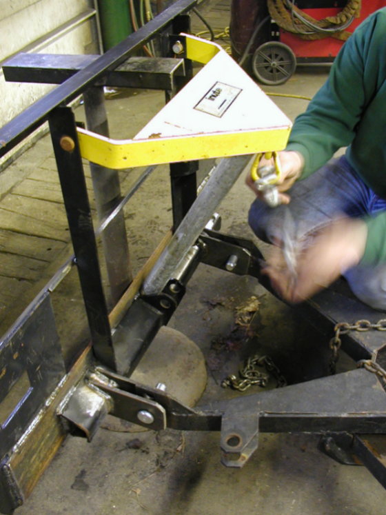

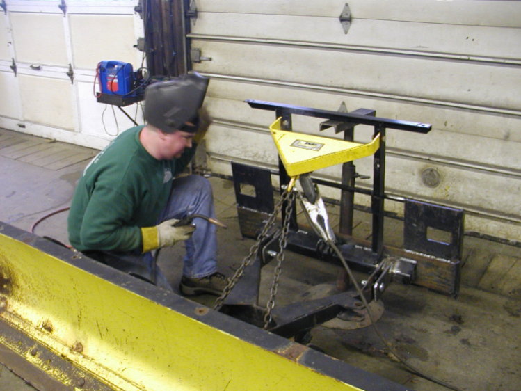

Jim,
I have reduced some of the photos taken at the welding shop. They will show better how the plows A frame is attached to the quick tach.
In this photo you can see the whole assembly. The upright piece is of course a tower from a Fisher Minute Mount plow. I obtained this from a local fisher dealer. It was a take off / throw away from a accident replacement. Freebee to me. /forums/images/graemlins/grin.gif

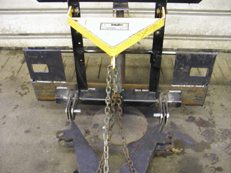

Jason the welder, welded a piece of flat stock to the lower portion of the quick tach plat for strength and support. Then he used his plasma cutter to cut 4 ears / tabs to conform to the shape of the lower piece of the tower. These tabs stick out just far enough so that the plow can pivot or float on it's own when necessary. So when one of the front wheels drops the plow more or less stays it's course.
If I put the FEL into the float position, it allows the quick tach and the plows A frame to drop and drag on the ground. So I just lower things enough for the plow to make adequate contact with the ground.
I spent 2 hours this morning plowing out my yard and my neighbors (landlords Mom). The plow works slick.

Heres another angle of the Tower, A frame and it will give you a close look at the ears / tabs that the plow itself pins in to

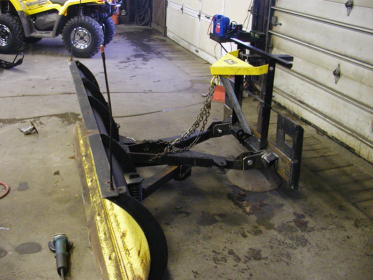

This photo shows Jason himself and another shot of the whole plow / frame etc.
It sure looks like the plow is going to get a good workout. I plowed lastnight for an hour, this morning for 2 hours and seeing how it is still snowing. I am sure that I will have to plow at least once more if not twice.
