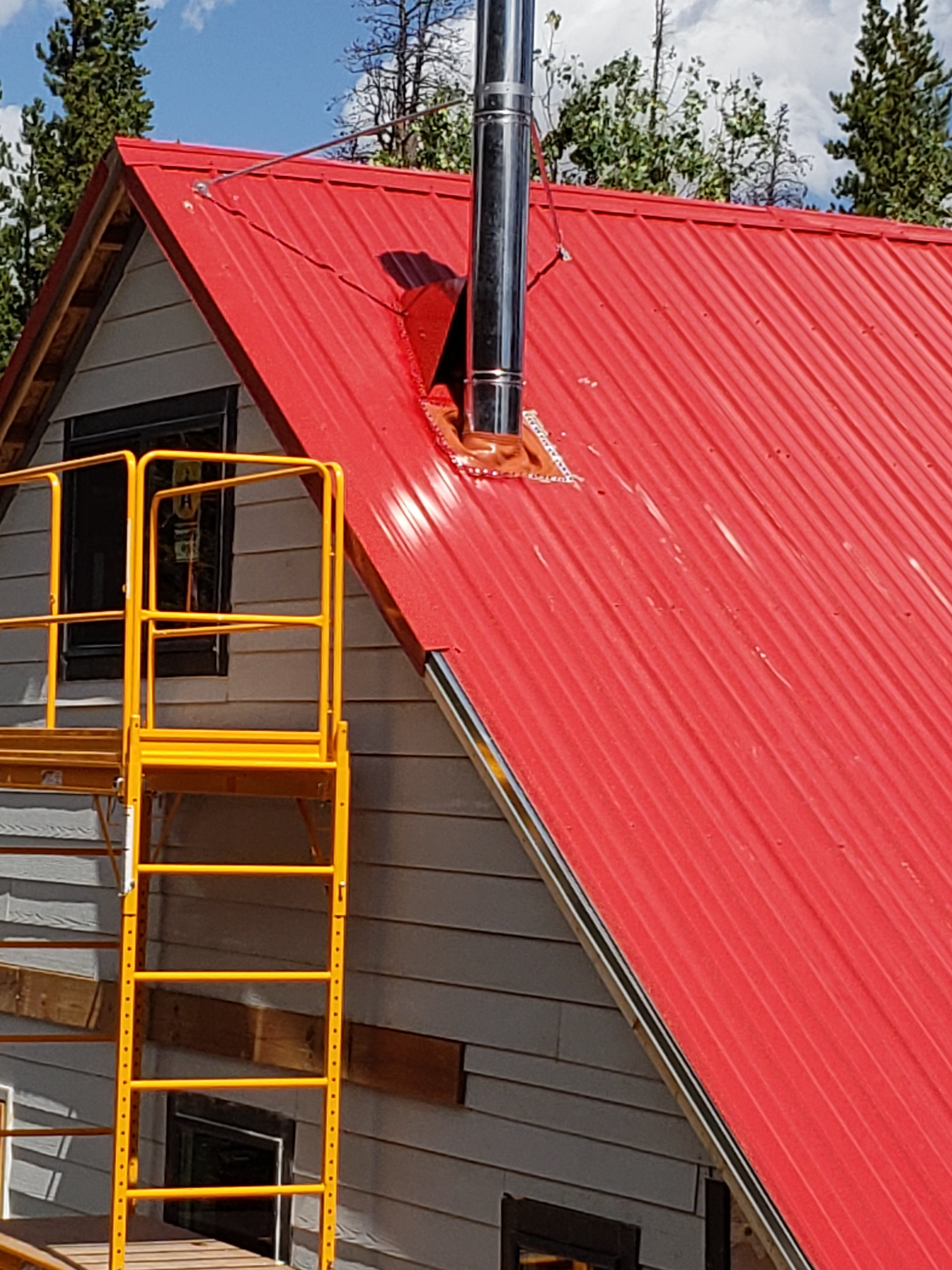

My cabin is a 10/12 pitched roof. I did it myself. Tie off and use a ladder to walk up and down the pitch. It's not easy, but very doable.
   / How steep can one put up a metal roof? #20
