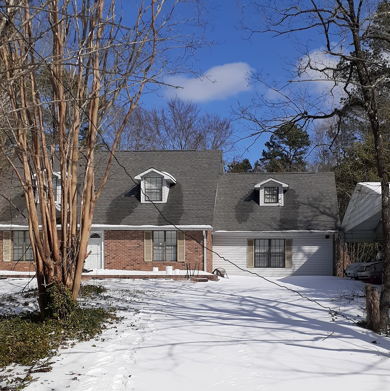

My house roof is moderately steep.
I was wanting to get a metal roof put on but the roofer I've used in the past (ONLY does metal) said it was too steep for him.
He's pretty good, and has done 2 house roofs and a 40x60 workshop for us, so I dislike trying to find someone else. He recommended shingles, but he doesn't do shingles.
Should I look for a different roofer for metal? (small town, few choices)
Or just go shingles?

Looks like a 12/12 pitch (12" down for every 12" over), shouldn't be any problem roofing that with the right crew.
I wouldn't do it unless you tear off down to the decking first though.
One HUGE problem with putting steel over an existing roof is that if you ever get a fire in the attic and it gets into the shingles, the house is gone.
The airspace between the shingles and the roof will let the fire spread all across the roof.

Not if put on with the right amount of insulation. The houses we've had done (ranches) are quiet inside even during a heavy Mississippi rain.

Metal no problem on that pitch, but get some insulation under it if you are planning on sleeping through rain.
