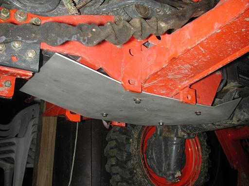

One thing I would recommend you do is to park the tractor on a flat place, set the brake, put the loader and any 3ph implement you may have on the ground, and then lay on your back and slip under the tractor and take a look at what is down there, hanging out to be wacked off (or jammed up) by a stick or whatever.
I know when I got my tractor I did not realize that there were a lot of opportunities to jam sticks in linkages, unprotected hydraulic lines, and filters sticking out asking to be knocked off. Including the fuel filter!
Knowing what is under there is a good thing.
I had something go wrong with the front drive shaft cover on my B2910 shortly after I got it. I think it was not installed correctly, and the plastic cover somehow got caught by a U joint, an one end was pulled in. It was fixed under warrenty, and I told the dealer that I did not think I did it, but that I did not know for sure.
Point is, I might have, because at the beginning I did not realize how much under the tractor is so unprotected...knowing what is under there can help you know how rough of ground you may want to run the tractor on.
I actually made a little skid plate to cover the area below the front drive shaft, just in case. I've attached a photo... /forums/images/graemlins/smile.gif Bolts to the loader frame and comes off real easy for oil changes.
There is a chance I may make something to protect the rear portion of the tractor bottom as well...
Just a thought in case you have not taken a look under there yet. I did not think to at first... /forums/images/graemlins/blush.gif

Very nice enhancement, Henro. ...gonna take a look under mine this evening.
