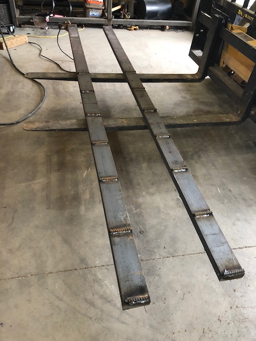

I started with two pieces of 1.5" x. 4" flat bar 10' long.
It wouldn't fit in the welding forum if there wasn't a little welding. I welded pieces of rebar on to the flat bar every 12" on both sides, staggered 6" on the front and back. I did this so the concrete could hold the bar in place and there was no chance of it pulling out of the concrete. I have pulled pipe fence posts before that were set in concrete and had the concrete stay and the pipe pull out

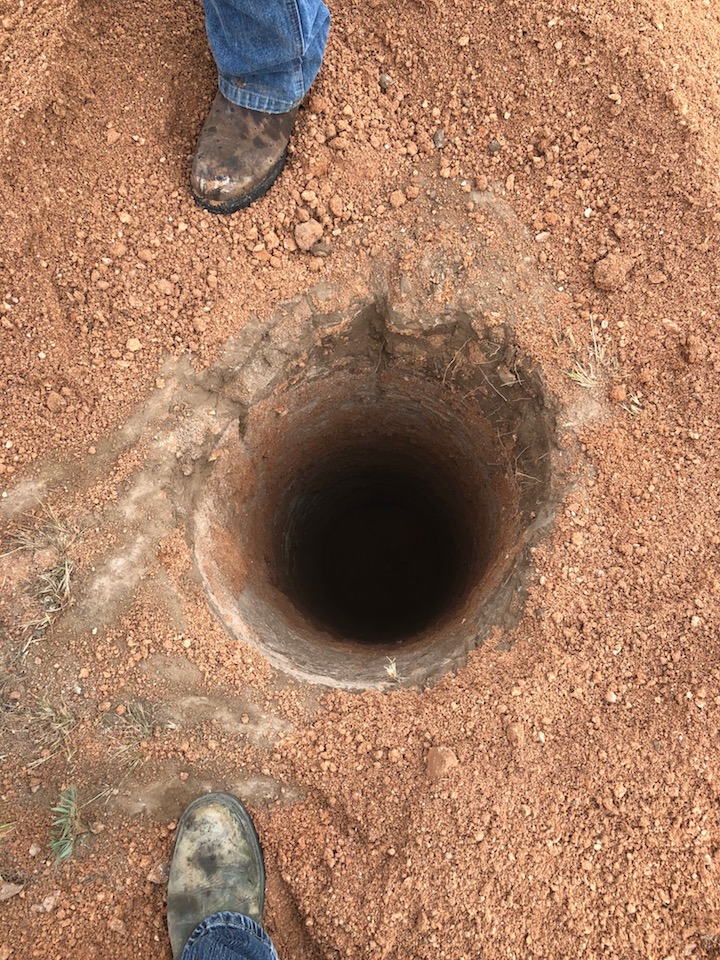

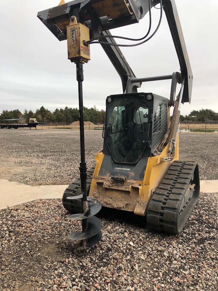

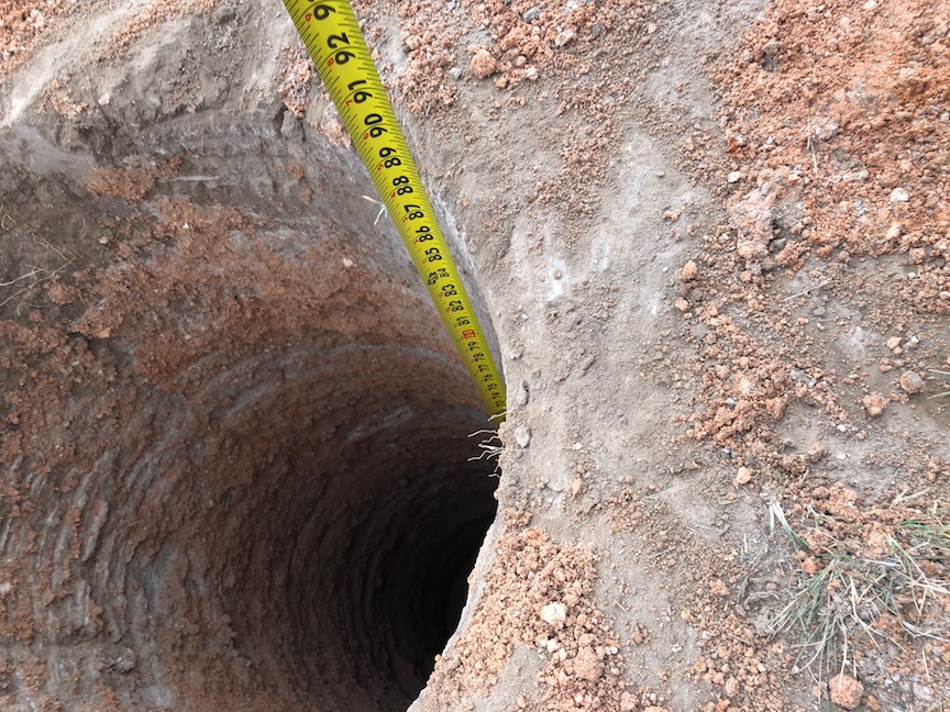

Next I got this ready to go to drill to the depth needed. That is an 18" auger and 8' from the tip to the gear box.
Then I drilled the hole. It is DEEP. I wouldn't want to fall in there though I am likely too fat to go very far.

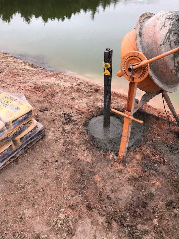

And last here is the bar set in place with 22 80 lb bags of quickcrete. The chain welded on top is what we used to lift it with the skid steer and lower it into the hole. Each bar weighed over 200 lbs. Tomorrow after the concrete is set I am going to drill the 1" holes in the bars approx 8-10" from ground level and cut off and round the tops.
