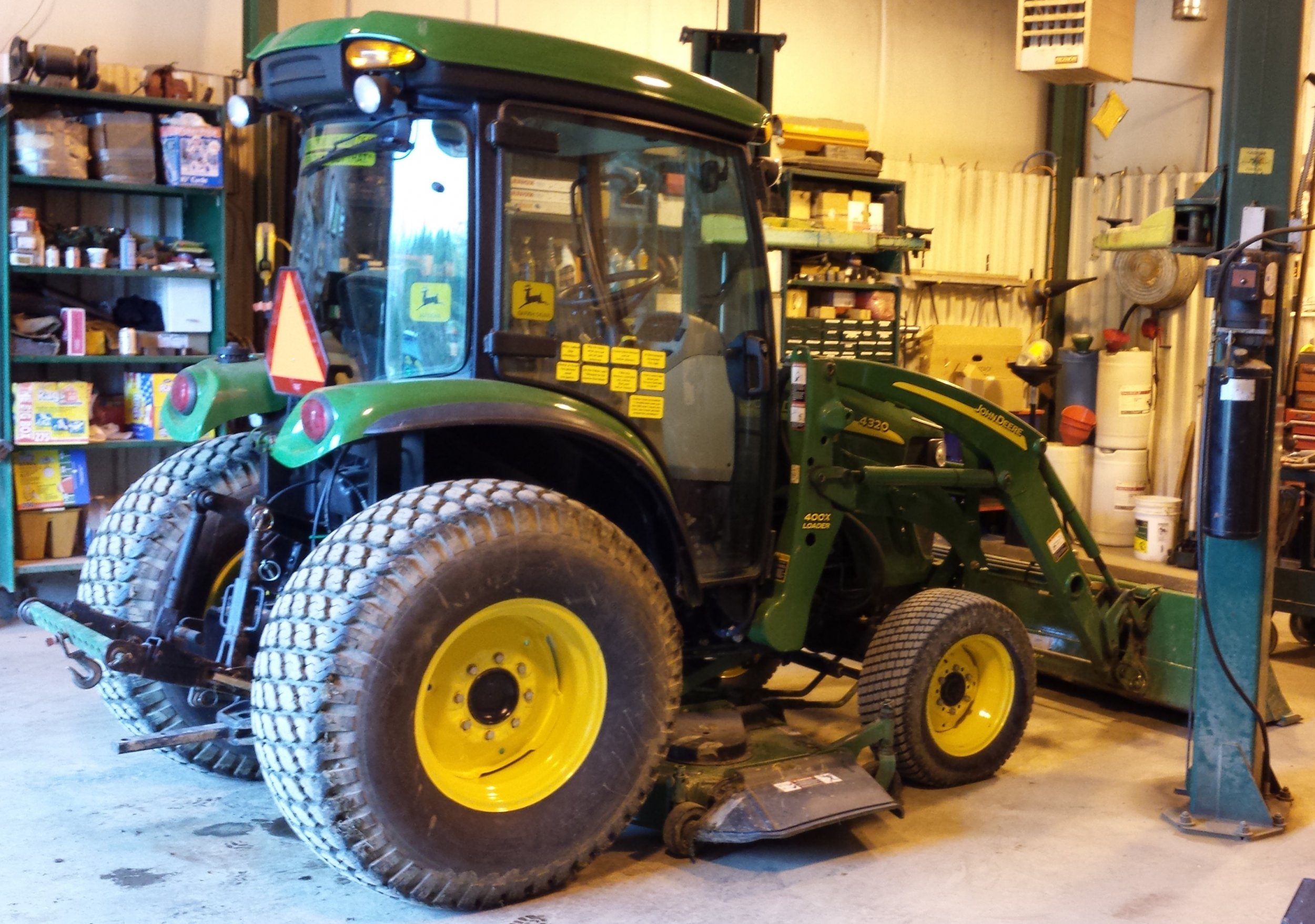

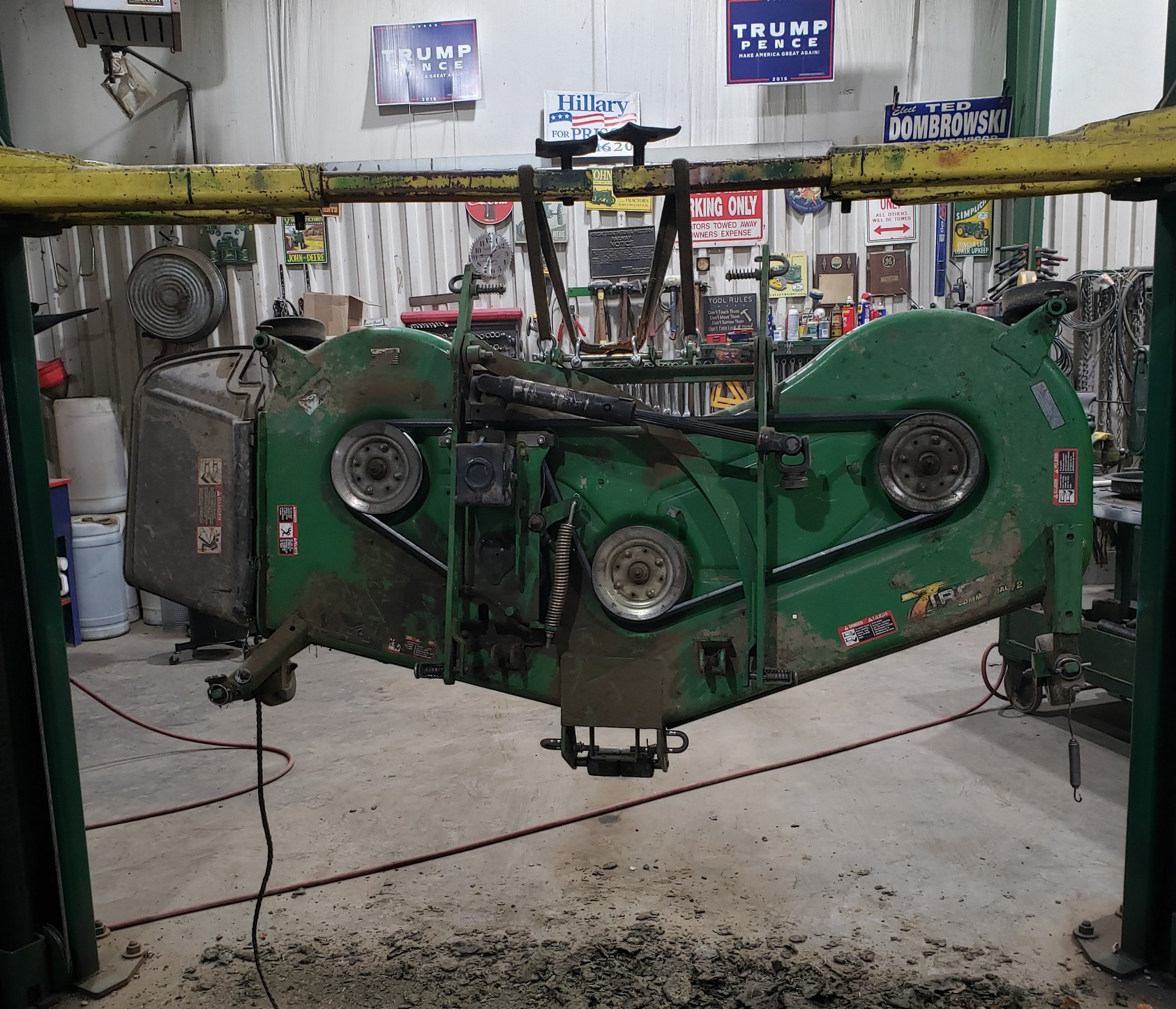

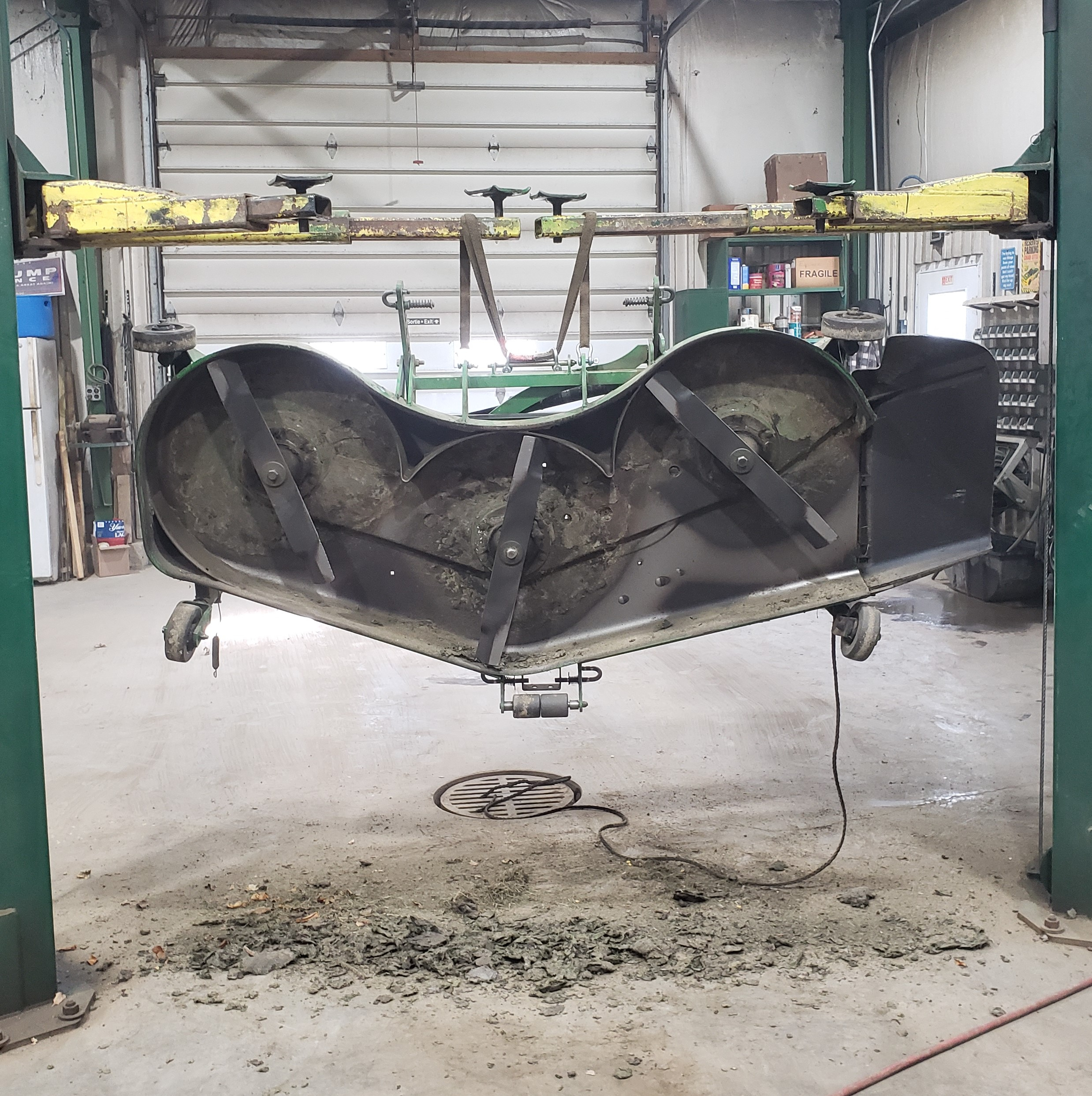

I have 2006 JD 4320 compact tractor with the mid mount mower/ 48 HP./ 2570 hrs. approx. That's a lot of HP that could hurt a mid mount mower deck. I grease it after every 3rd/ 4th mowing. Mowing time is approx. 1 hr. and 30 minutes. The loader comes off for every mowing. Its been 17 yrs and here is the Items I have replaced. Two complete sets of ground wheels/ now $51 each, they don't really last that long. One tensioner pully 2 years ago, it was non greaseable item. I am on my 4 set of blades, now about $80 plus per set. It still has the original belt. A new JD belt is like $230, wow, if I remember correctly. One yoke and universal joint on the mid PTO side. U joint was good but the spline was getting loose. I think this was under $200. I changed the gear box oil one time years ago. It might be due again. Although this oil was not milky like my snow blower gear box oil was. I am planning on getting at least another 10 years out the mower deck. I am 74, the mower deck may out live me. The pictures show cleaning the deck, I do that every fall. It gets a wash job, grease, stored and covered in the heated side of building, ready for next year. Later.
