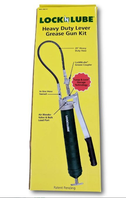

LockNLube also sells grease guns: https://locknlube.com/pages/grease-gun-charts
If I need to get a new gun this would be it:
