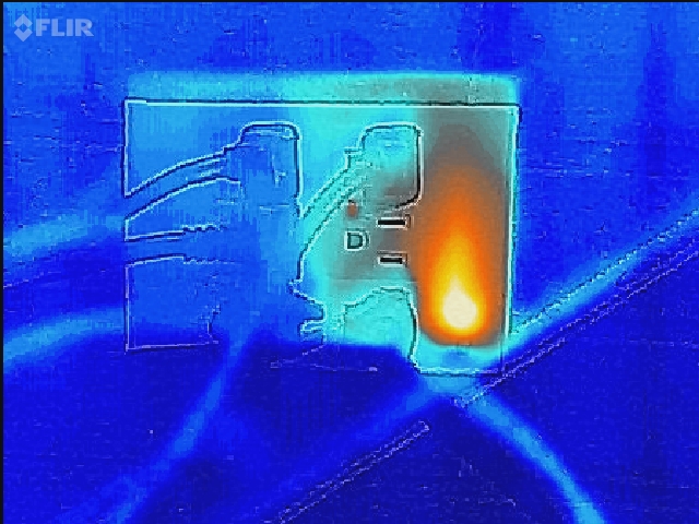

Take a look at this: I just bought a FLIR/ONE thermal imaging attachment to my Samsung Smartphone. $250
One of the first images I point to is my surge protector for my computer stuff. It indicates a very HOT spot inside the surge protector box that must be a transformer or variator or omething. Its not a plug outlet. None of my other surge protectrs are showing this indication, so I just ordered two brand new ones. This situation would make for a highly possible fire in the wall where the plug is if the protector melted down.
This FLIR/ONE consistes of two cameras: one for the infrared and one for subdued visible so you can see an outline of the object(s) you are 'seeing' in heat. Its pretty 'cool', actually...
Good catch. My dad got a box of free energy saving bulbs, etc, from the electric company a couple years ago. A surge protector was included. He swapped out his old surge protector at his desk with this new one. A few months later, it smoked and melted, nearly starting a fire before he pulled the plug on the smoldering mess.
