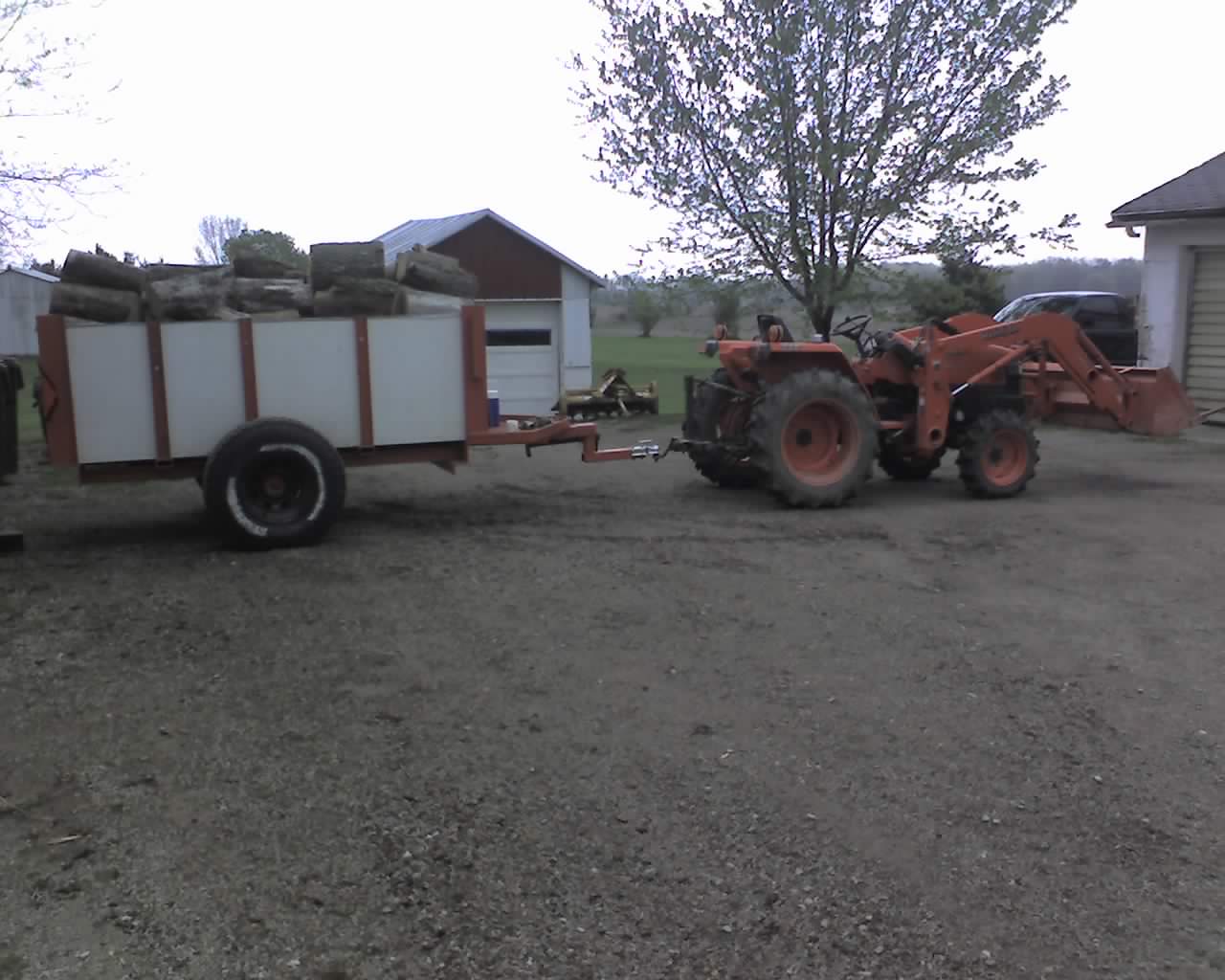

I know I am going to be drilled by the saftey police here but I have a kubota 3400 and regularly tow a trailer in and out of the woods and even 3 miles down the highway (thats where we cut wood) that weighs~2000lbs empty and a full cord of wood on it 3500-4000lbs. Total of between 5500 and 6000 lbs. I have never had a problem pulling or stopping. But no major hills. The biggest ones are on the highway and pavement provides good traction.
I'd say build it as big as you want. (from a manuverability and storage standpoint). If it is too much, don't load it to the max.
The load in the pictures was towed 3 miles down the road and in/out of the woods

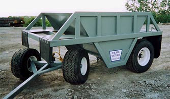

this is a smailler version at a yard.
