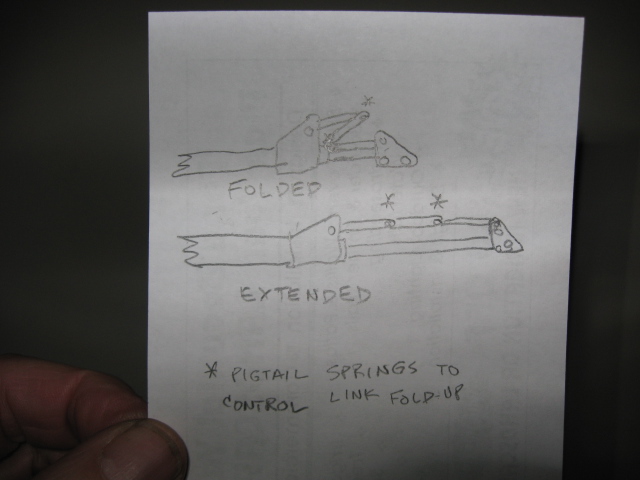

Do you have room above for a folding truss link hinged to the right end that could function when extended and be anchored/hinged/tucked above the junction of the telescoped sections when not? This would put a tension load on the truss and a compression load on what looks like an extendable boom or something. Either of these easier force distributions would seem to increase lift(?) capacity vs the bar alone with its typical deflection. (Not much to go on ... I imagined this..):
All the easier if the bar doesn't telescope to use/store, but a 1pc truss could be 'pinned on' at full extension, too.
(I claim insomnia ... sorry if I'm 'out there')

Do you have room above for a folding truss link hinged to the right end that could function when extended and be anchored/hinged/tucked above the junction of the telescoping sections when not? This would put a tension load on the truss and a compression load on what looks like an extendable boom or something. Either of these easier force distributions would seem to increase lift(?) capacity a good bit vs the bar with typical deflection. (Not much to go on ... I imagined this..):
(I claim insomnia ...)
Now THAT is thinking outside the box! HA! I will be thinking about that ! Ha!
Gotta love TBN, there are some great minds here...

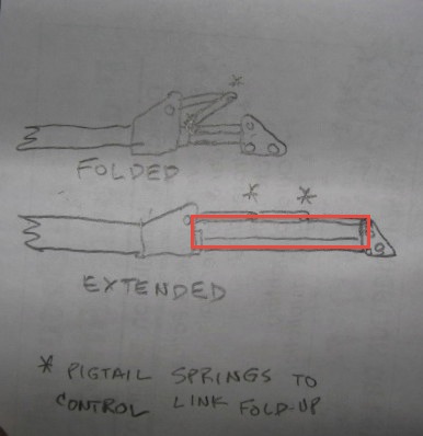

A folding brace is an interesting idea but it would be stronger as a triangular design.
The rectangular brace will keep the end vertical as the bar bends but won't do much to stop the bending.
Bruce
