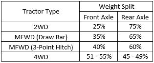

I know there are a lot of variables involved, but is there a general rule of thumb on how much weight you should have up front?
   / How much weight up front? #2
I dont know of any general rule.....and even if there was most people dont have a way to measure it. Most just go by instinct. Steering too light you need more. Rears keep breaking loos is too much up front not enough in the back.
4wd it is beneficial to make sure the front has enough weight so those wheels can actually assist. 2wd you just need enough to steer.
Those old fords are heavy tractors for their size. ~30% heavier than your new MX. Do you plan on using the same attachments with the new kubota?

25% of what is on the rear.
   / How much weight up front? #7
Interesting question, but it’s not the weight, it’s the torque.
That is, how far the weight is “out front” is just as significant as the amount of weight.
If it’s twice the distance you only need 1/2 the weight.
That is why i said 25%. Figuring rear axel to 3pt hooks about 1/4 rear axel to front weights........ for a typical compact tractor......
