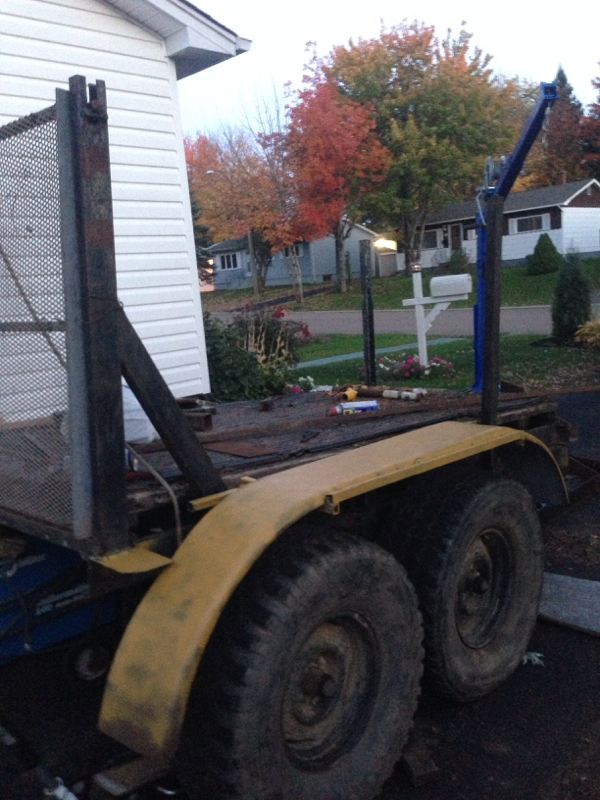

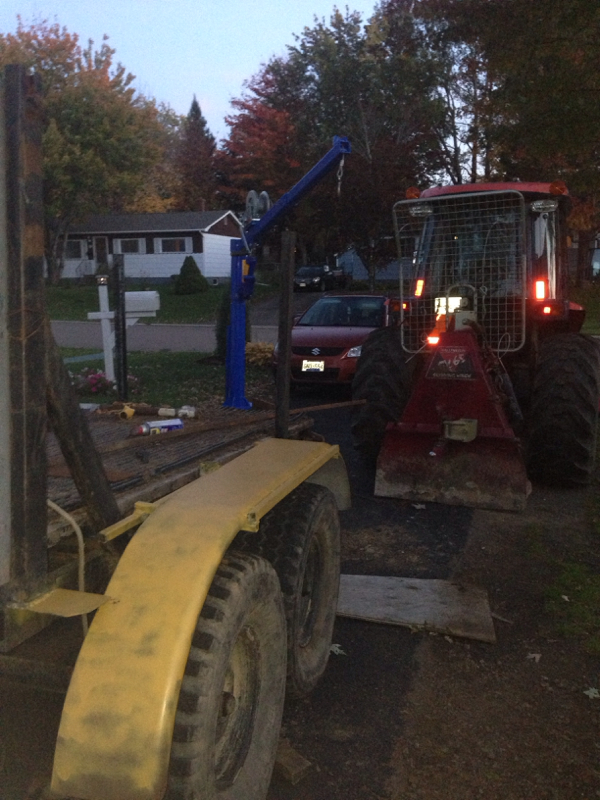

A cord of green maple is 6000 pounds. I have a l4740 and I can pull a cord in good going with my good trailer. I usually go with 3/4 of a cord or Evan 1/2 cord if haul is less than 1000 feet.
   / How much weight can I safely pull with my CK27HST? #20
My trailer has 33 inch tires with walking beam suspension. Will walk over stumps 2 feet high. May be a bit overkill for 1/2 cord but nothing gets broken that way.
