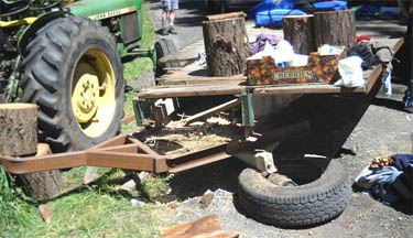

I want to rig up a wagon to haul firewood and anything else I see fit to haul, but I am wondering about weight vs traction.
Maximum weight would be around 5 tons/10,000 lbs.

Tongue weight won't be a problem as the wagon has a steer axle as well as the rear axle.

You can pull way more than You can stop. 5 ton trailer will push you all over. Best way is load a little and try until it seems to heavy. I would try a little less than your tractor weighs

A properly made wagon should go anywhere the tractor can. As for how much weight you can safely pull will vary from day to day based on variables from temperature, ground moisture, tire wear, and many other factors. There are many things that can create limitations and there are too many to predict. Best is start small and work your way up to heavier loads slowly and learn the limitations of your environment and equipment carefully.

Thanks guys. That gives me a base figure to use. I can forget 10 thousand unless I put surge brakes on the wagon.Brakes wasn't in the budget, but I will if I have to. My life is worth way more than brakes.
