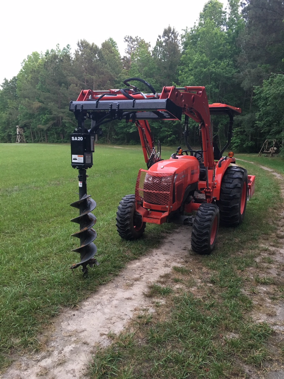

I have the Landpride SA 20 mounted on the loader. Our tractors are similar in size and my SA 20 has the 6 to 15 gpm motor. I run a 12" auger and have been pleased with the unit so far. We have a mix of clay and sandy loam soil. It doesnt spin fast enough to clean out the holes in the sandy loam, but works well in clay. Down pressure is great as is the option to reverse. The slower bit speed also helps with overall control. I use the offset mount for better visibility. Last I run the hydraulics through a WR Long 3rd function kit.
Do you have any issues with your 3rd function kit overheating with the continuous use?
This is a great question. My lines get pretty hot while running my chipper feed hard, leaving it on.
