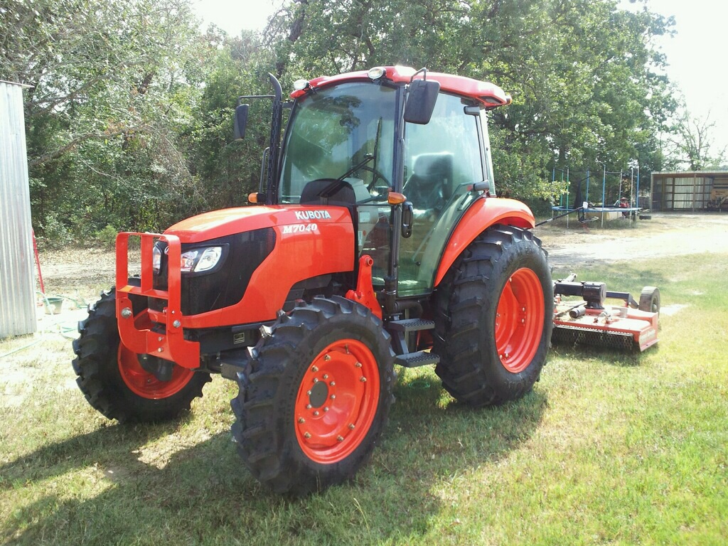

image.jpg my 7040 with the 8ft LP(RCR3596) covered tracks,pulled no problem.

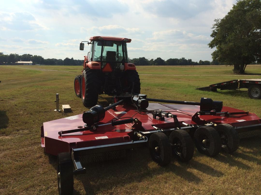

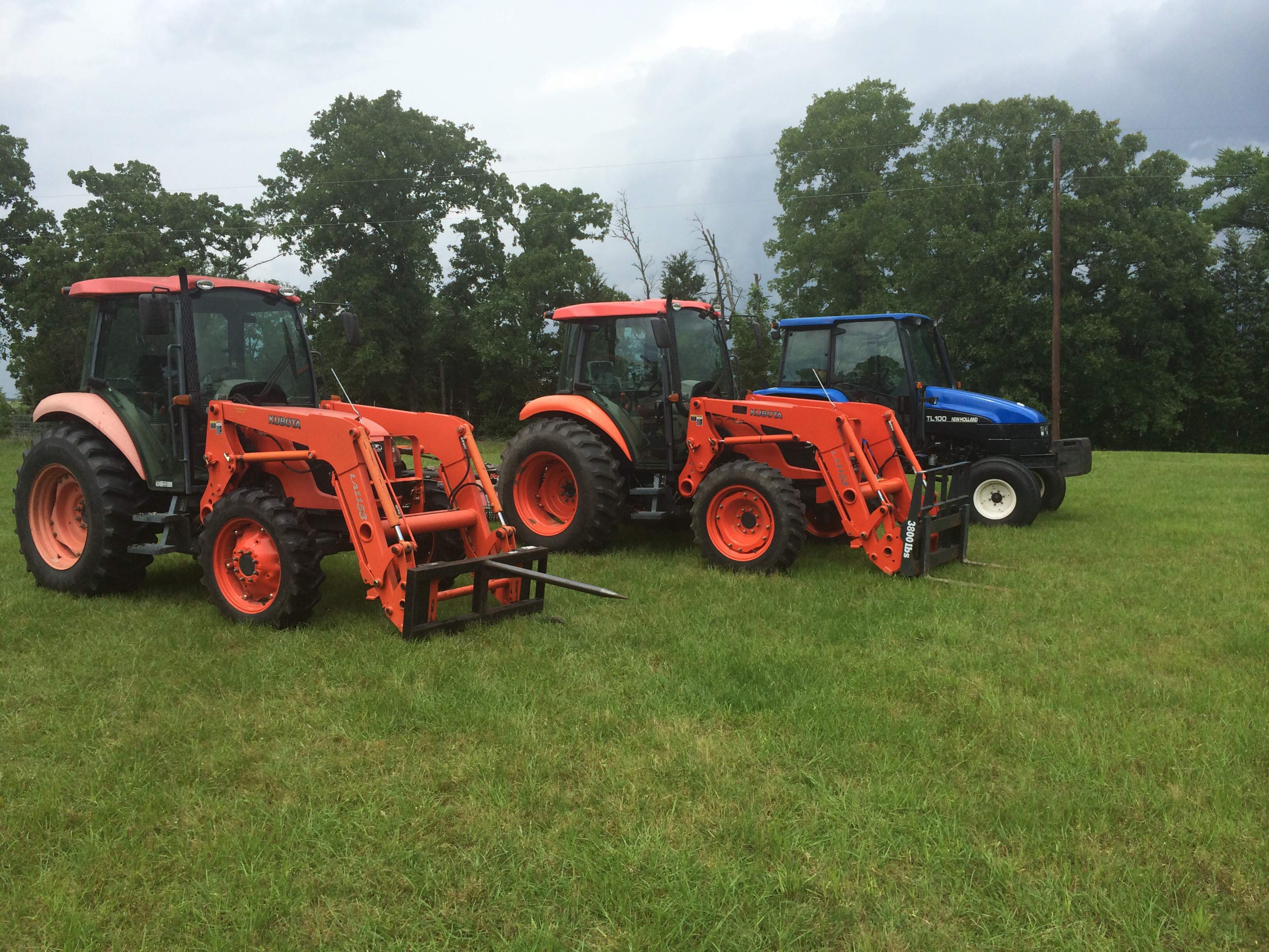

image.jpg sold the 8ft and went to 15ft LP,no regrets I think does a good job pulling it. I did just get a sweet deal on a TL100 and that is going to do the shredding and baling. I will still use one of the 7040's to pull the 12ft if need get something done and knock out quick on some my lease places. Well I may put the 12ft straight deck on the TL100 cause it seems like harder to pull than the 15ft batwing. image.jpg

I'll be keeping my 6ft just incase I have some larger material to cut. The new 12ft I'm looking at is only rated for 1.5"
/ How much HP #19
Yeah I noticed that all the 12ft batwings had the 1.5" rating. What trailer do you have? That 7060 and 12ft shredder is probably going to require at minimum 25ft-14k and it barely fit,a 28ft would be better. I tow my 15ft batwing by the receiver hitch on my 25ft trailer,the tractor with 8ft would fit and ramps would rest on the rear tires of mower and have to strap them down. I use a 1ton dully so weight on front of trailer wasn't a big deal for me and backing on would leave my tractor to low on dovetail. I at first backed shredder on and unhooked(used loader to lay tongue on deck not let ride on jack) then drove tractor on trailer and it was loaded better on trailer but sucked having to unhook and hook it all back up. I am looking to get a 32ft-20k trailer next,I wish I had atleast got a 28ft if not a 30ft-14k the first time would have worked better until got to where I am now.
