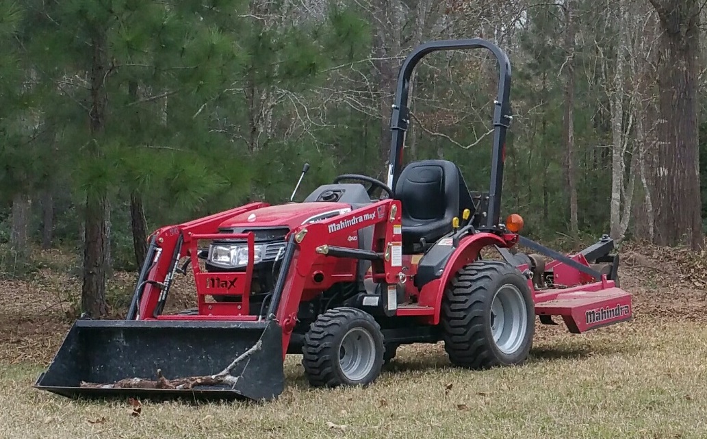

I bought the 25 hp Mahindra. I definitely feel I could appreciate some more hp. I have a very steep driveway and the middle range the engine Boggs way down going up that hill. Low range has a lot more power. I still think I made the right choice as the price and simplicity of the non emission engine and I think 25 hp is enough. More would definitely be better.
Any aftermarket tuners available for tractors?

After having this a while now I'd definitely say if anyone is reading this post wondering if 25 HP is enough I'd say NO! Unless maybe you have a totally flat piece of property. On the other hand I also can't imagine having a DPF on a light use tractor! I use mine to pick stuff up move it or pull trailers around. I'd never be able to do a proper regen with my small piece of property. To be clear this tractor empty needs to be in low range to climb my driveway. My driveway is a bit steep, but nothing interesting. I think in hindsight I should have searched harder for a good used pre emissions higher HP tractor, but when I was looking there was nothing decent out there.
/ How much HP do I really need? #75
See now I feel differently about this. I have driven home 4 different tractors (all HST)from my local dealer and have a decent hill that I have to go up to get to my place.
A 3550, would not go up the hill in high range, just wouldn't. :shocked:
A 1533, same thing, would not go up the hill in high range. :eek:
A 1526, went up in high range without even slowing down. :thumbsup:
A Max 26XL, went right up, but did slow just a little. ;)
Yes I under stand how to use HST, let off the pedal to get more torque. On the 3550 and 1533 I did just that until they stopped, they simply would not pull the hill in high range. So I guess that the power to weight ratio is much lower on those machines. Took right off in mid range, but no deal in high.
Now I have also brought home a 2540 gear model, that thing was like a little rocket ship. Surprised the heck out of me how peppy it was. :cool:
Ultimately it comes down to what you want, are willing to pay for and or willing to compromise on.
All choices that we all have to make. ;)
