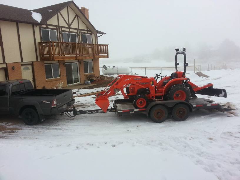

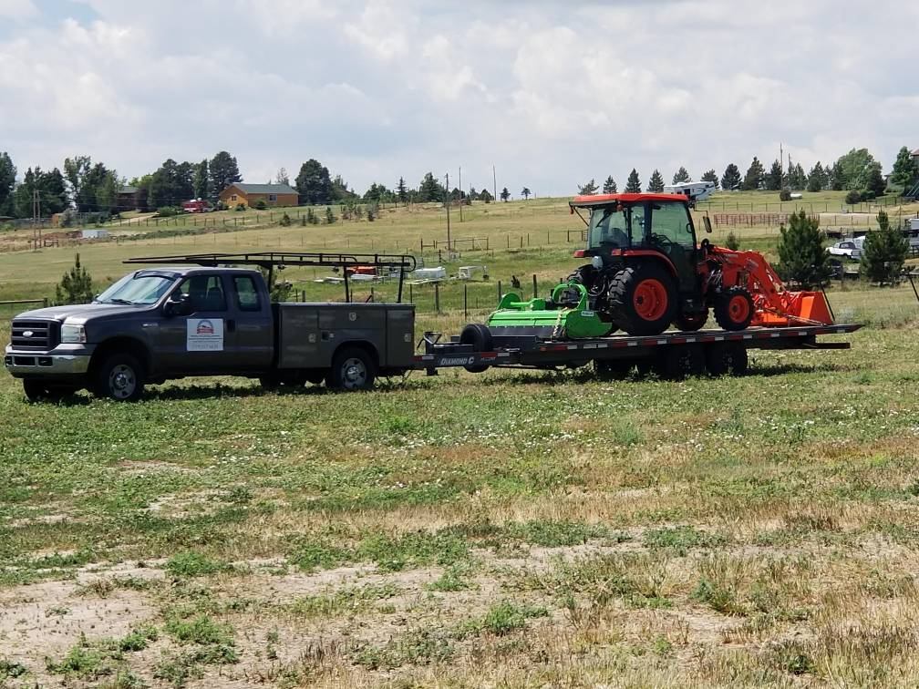

I picked up a beater F250 (cab & a half with an 8' service body on back) after it became apparent my 2009 Tacoma couldn't pretend to be s 1/2 ton, much less the 3/4 ton I needed for hauling the old L3200, buch less the impending L4060HSTC. I'm planning on replacing the Taco & F250 with a newish 3/4 ton diesel in the next year or so. I may or may not also get a cheap econobox commuter. I work from home a lot, so it may not be worth it to get a commuter car.
My question is how much does truck length affect towing stability? I know the longer the better, but long is painful in parking lots & tight spaces. I'm planning on a double cab, but debating what bed length to get. I'm wanting a short bed for manuverability. Bed capacity isnt super relevant. My Taco bed mostly works for my needs now. And if it's not big enough, I have the 22' deckover. Any good arguments against a double cab short bed for hauling a 14k 22' deckover bumper pull (4k itself) with upwards to 7k of tractor & impliments on it?
The current beater F250 is a little twitchy at times, mostly due due to a sloppy gearbox (I assume, ball joints & tie rods are tight).
All things considered I'd like to keep as much manuverability & possibility of fitting the truck in the garage. But its main job will be trailer hauling, so I need to optimize for that if I can. 20180618_122125.jpgIMG_20140209_103618.jpg

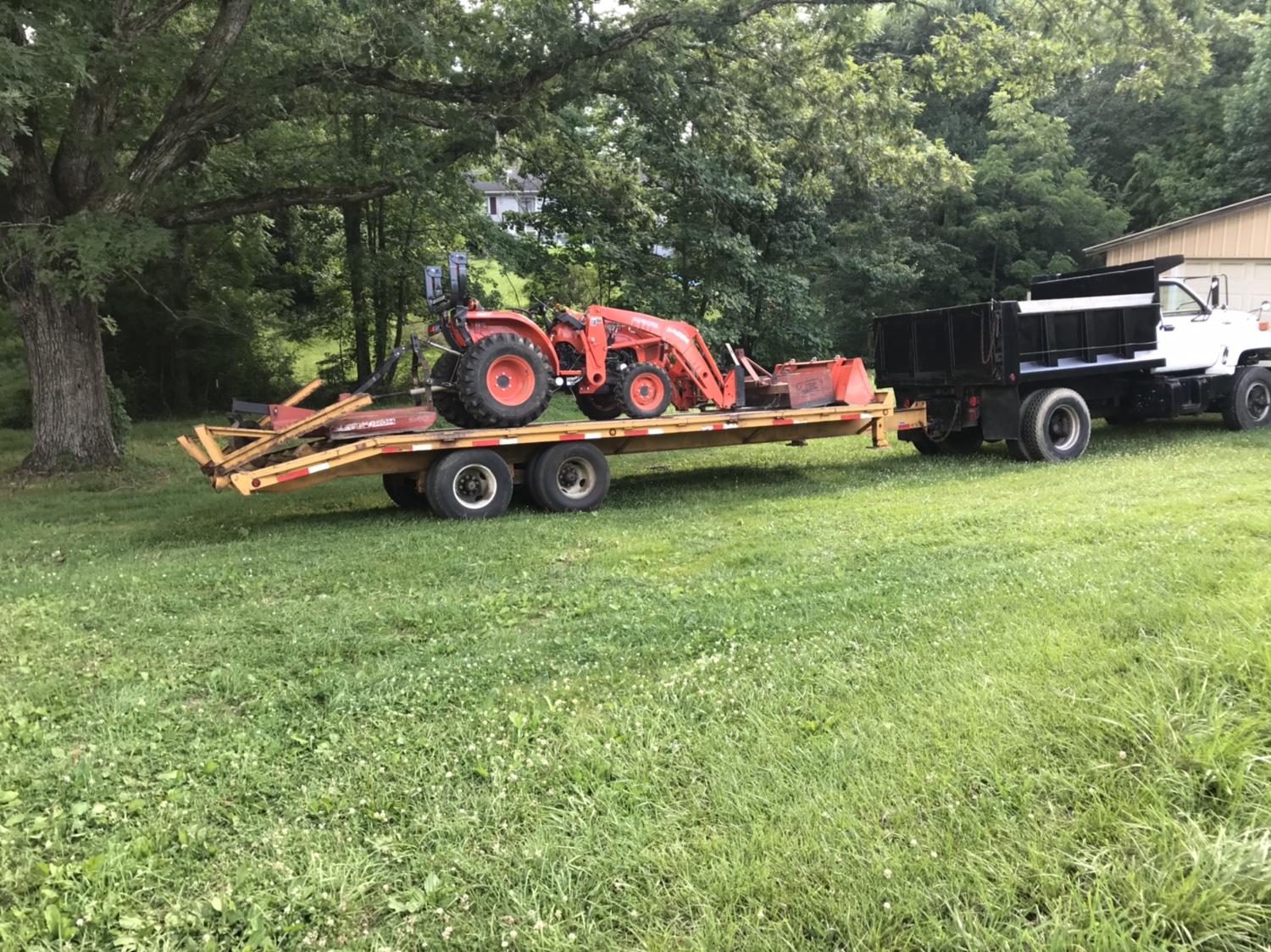

Depends a lot on the truck and how it's being used, if you are towing at or beyond the trucks limits then you'll notice a difference in wheelbase, also depends on trailer type and engine. Tag along trailers will benefit more from a longer wheelbase, also a lighter engine option will make a shorter wheelbase truck feel less stable (i.e. gas vs diesel).
I've had experience driving almost identical trucks but gas/diesel, different wheelbase. Largest truck I had that I towed with was a diesel Crew Cab F550 long wheelbase, it didnt really care what was behind it!
I'm in your same boat, I work in DC, and while I don't drive my truck there often, I needed a truck that I could park at work when needed.
I currently have an 07 crew cab shortbed Dodge CTD 4x4, and while I've towed more then I should have in the past by accident (close to 20k est with my dump trailer) and it has worked, I would have just sucked it up and gotten a long bed if I was towing at its limits everytime.
Once I retire from this job I plan on getting a long wheelbase dually!
