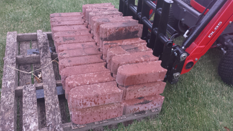

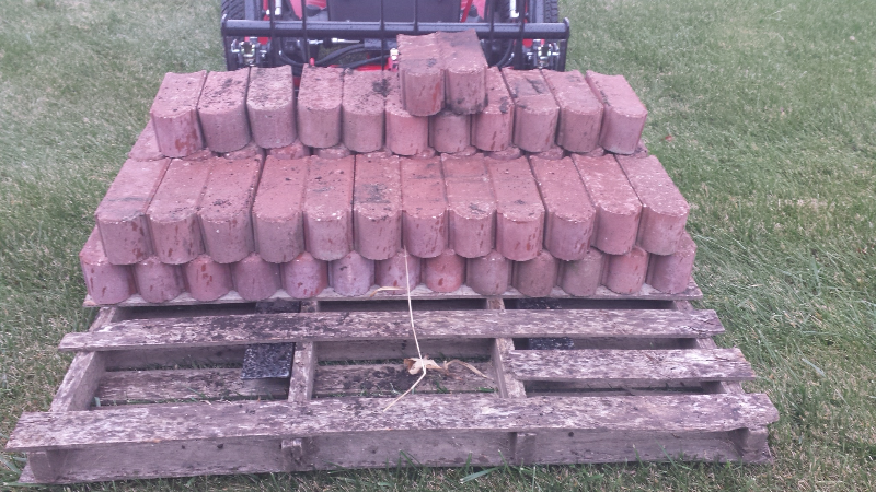

Greetings,
Thinking of scut cersus small cut? Staring at brochures but can't find all the answers?
Well maybe you'd like to actually know what a sub compact tractor can actually lift in real life.
So I took my Massey GC1715 scut tractor . . Took the bucket off because it wasn't big enough to use for the test . . and did this:
GC1715 with DL95 loader:
The brochure wouldnt tell me so I tested how much weight the fel can lift. So on two different days I actually measured.
1st time I previously wrote about and it was 864 pounds of actual concrete I moved on pallet forked effort.
But I did it again yesterday in very controlled conditions to be completely fair.
Fel minus bucket.
Add 77 lbs for the quick attach
Add 115 lbs for the forks
Add 26 pounds for a cheap pallet
Add 63 concrete edgers scaled at 15.3 pounds per piece (963.9 lbs. Of concrete).
At 3100 rpm I was able to pick it up and move it 50 feet and set it back down. But then after a slight drizzle and a 10 minute rest . . I was not able to re-pick it up to take to destination . . so I removed 2 then 2 and finally 2 more edgers then making it a total of 57 edgers (872.1 pounds)
A dl95 loader on my gc1715 at 3150 rpm lifted and transported 200 feet up and down an incline the following
77 lbs + 115 lbs + 26 lbs + 872.1 pounds of payload in a single trip. Total weight = 1090.1 lbs. Plus some rain water and 2 earth worms :)
I'd say with a mini grapple I'll be able to haul a good sized log or a biiig biiig bucket of rock :) Don't you agree?
Also . . Consider the 3 pt carrying capacity is even larger than the fel.
And here's a picture after I moved it the 1st time.

I also was surprised as the brochures always speak based on bucket installed. Even so the numbers imply with bucket on I could lift "safely" much more than brochures seem to say (bucket is 155) so if fel lifted a gross of 1090 lbs then 77 lbs for quick attach and 155 lbs for bucket means I could safely lift at least 858 lbs in the bucket. I say "at least" because in the bucket in right over pins whwre in mt forj lift test the weight is farther forward and leverage effected to the negative.
I was surprised how rpm made such a difference.
I wish others couls test their bx or yanmar unuts similar to mine. It shows 175 lb increase from what I read is brochure claims and that could impact decisions for some between scut and cut.
And one last thing . . On flat ground . . With all that weight forward . . It didn't pull the rear tires up at all . . Even with me off the tractor.

Your math is slightly flawed. It doesn't matter how much your bucket or pallet weigh you still have to lift them.

Greetings 4570, I'm confused . . I included everything in my calculations from fel arm end to payload. The numbers I showed should be all inclusive.
