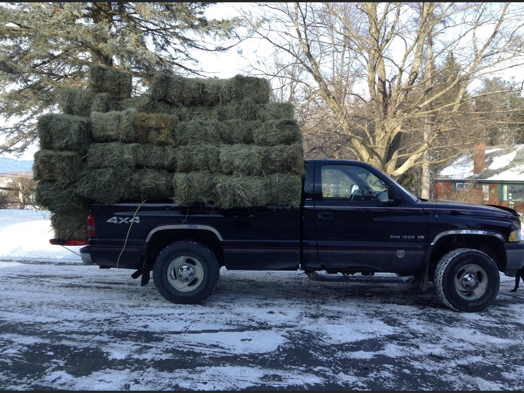

This would of been 70 bales on a 8’ bed if I’d loaded the top differently and really wanted 70 bales.
I don’t think a normal van could carry 1/3 of that.

Don't bet your truck title on it.
Small bale size confirmed earlier as 18w x 14h x ~ 36L
My T-350 cargo van area 90" H x 150" L x 56" between wheel wells / 72" above wheel wells wide.
1st row - 12 bales: 4 long (+/- 144") x 3 wide (+/- 54”) = 14" high
2nd - 5th rows (above wheel wells); 20 bales each: (5) bales stood on 14" side (+/- 70") wide x 4 bales long = 84" overall high
Drop 3~4 bales due to weight capacity = 88 bales.
And yes, I've spent many a summer day putting up hay as a teen
