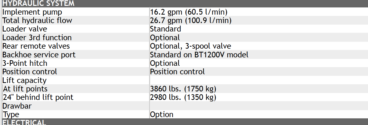

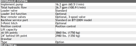

Yep. It's a perfect example of what I said back on page 3.
"Good luck for anyone trying to compare apples to apples by using advertising data. The people mixing numbers to make those advertising data sheets are masters at making their product look the best - whether it is or not. "
Purely true, and also completely misleading BS information. Implement flow is 16.2 GPM on the M59 and even though it is not to be used continuously, it is still large enough to be something they could brag about. But instead they tried to pull a fast one on eveyone by adding together all the hydraulic flows in the tractor whether accessible or not.
The Canadian spec sheet broke it out properly and so does Kubota's own shop manual.
Typical advertising BS from the industry.

rScotty,
Thanks for clarification using workshop manual. I should have looked in my workshop manual before responding to Smokeydog. Mine was knee jerk reaction.
Welcome for sure. I don't like pushing the negativity button, but the whole idea that a person can compare tractors - the subject of this thread - is fun to debate here on TBN between owners like you and I who know better. But for a newbie actually believing in being able to judge tractors by comparing tractor advertisments is kinda crazy and scary.
Somehow us old timers have been part of creating a whole generation of new buyers who think that they can trust advertisements. I'm as guilty as anyone; I want to believe them too.
I know for certain that my generation grew up knowing that advertisements were not really to be believed, and somehow we didn't pass that along. What happened?
