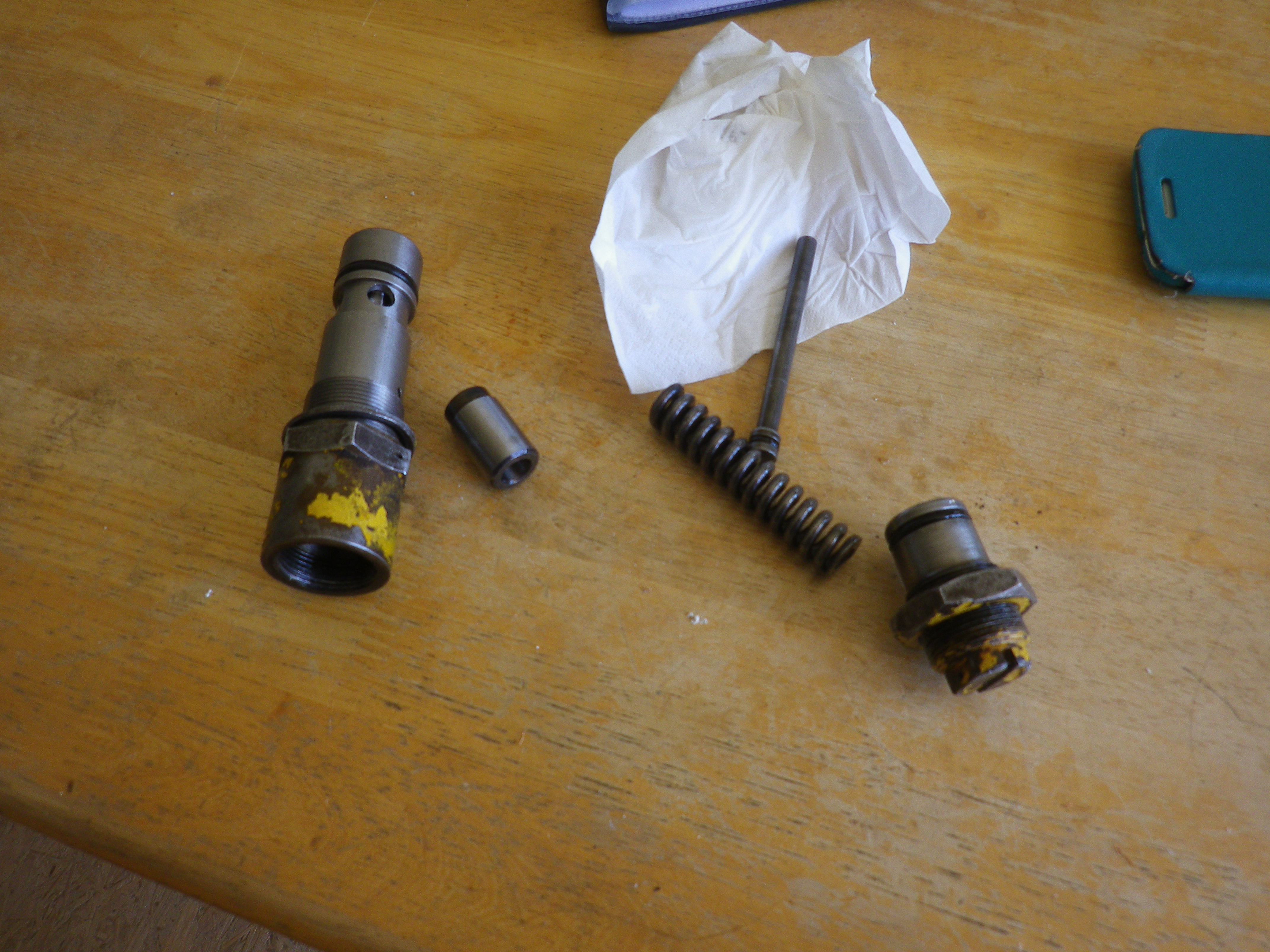

I have an old backhoe, which through my rough use, has stopped working. I have been using it for years until at full depth I hit a large rock.
The pressure blew the pump, but I think also the valve I describe below. I have replaced the pump and a piston which got bent, but it is not working.
I am pretty certain this one-way check valve (maybe also a relief valve?) is now not doing its job, and is the issue. It controls the pressure and return flow of the oil (I think!).
But, I am not certain how it goes together and so is supposed to work. It fits as a cartridge in the end section of the manifold taking the return line oil in.
It needs to let the oil through itself so that it can come out of the manifold and return to the reservoir, but I don't know how this is supposed to be done.
The main cartridge has a conical plug fixed in it. The plug screws on to the cartridge with the spring inside pushing another conical plug against the one in the cartridge.
This seems to stop the flow completely, as there is a rubber "o" ring on the cartridge to stop oil passage on outside. I don't know the function of the plunger.
The attached photo shows the bits, but it is possible I have lost a piece as is spring loaded and shot out in disassembly.
Any help would be greatly appreciated.

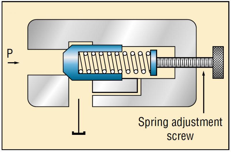

Well it shouldn't block the return flow. There should be no flow through it until the set pressure is exceeded, then it opens and allows flow to the tank.
Here is a diagram of a basic PRV, from a google image search:

In the picture of your first post. Is there still a spool or poppet inside the largest/longest piece?
Is there a small hole in the center of this spool or poppet?
Spring looks large enough to a direct acting relief but possible it is pilot operated style. If the hole in the main spool or ppet is plugged the valve will remain open bypassing all the fluid at a very low pressure.
ok, I see - thanks for this. This is exactly what I need to get to its design.
I don't think it is (just) a pressure relief valve then. The manifold has no other valves and so I guess it must act at least partly as a pressure relief. Could it be acting as a pressure relief and check? When the flow through pressure is too high it could push the spring back and release pressure by oil flowing back through it. In normal operation it simply allows oil to flow through, but stops any return (unless the pressure is high). I am making stuff up here in order to try to understand. I have looked at the design of various valves one gets for diggers, and trying to understand this design.
Thanks for the response.
There is a poppet inside the cartridge, and it does have a hole in it. This is poppet is the valve seat I guess and is plugged by another poppet that is held by the spring.
I am no expert here so I am afraid I do not understand why the valve remains open. The low pressure return flow of oil comes into the cartridge; I don't understand how it can bypass.

What are the flow paths or ports connected to this valve?
What you are describing sounds like it could be a pilot operated relief. The main ppot is held in place by the the second pilot poppet and spring. When pressure builds up on the nose of the pilot poppet it lifts off allowing the main poppet to open a flow path from pressure to tank. Some relief valves also have the option of free reverse flow for anti cavitation function. This usually requires a very soft or weak spring to accomplish this.
If the passage in the main poppet gets plugged or a small piece of dirt gets caught on the pilot poppet seat the valve will fail open allowing oil to pass at low pressure to tank.

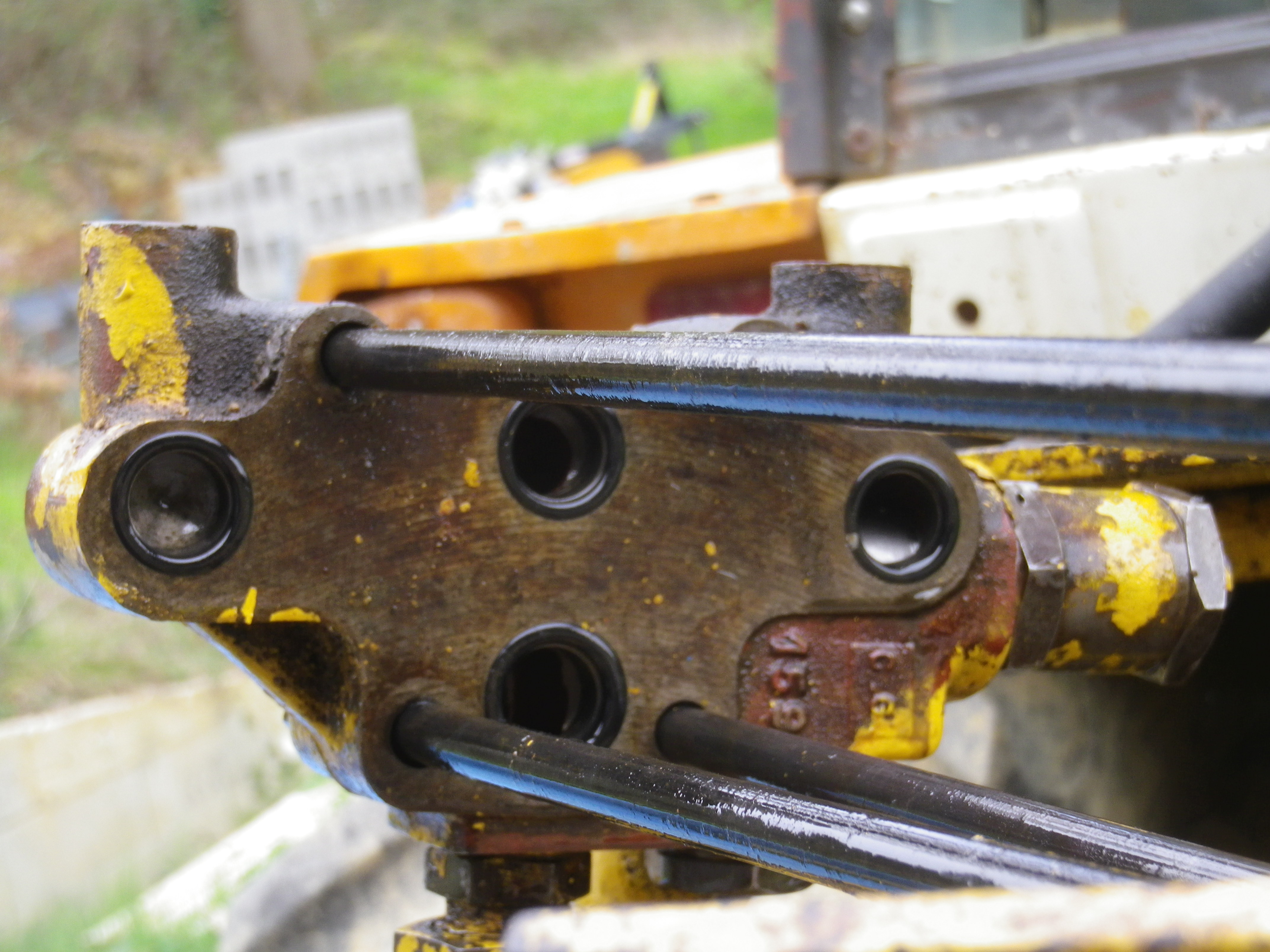

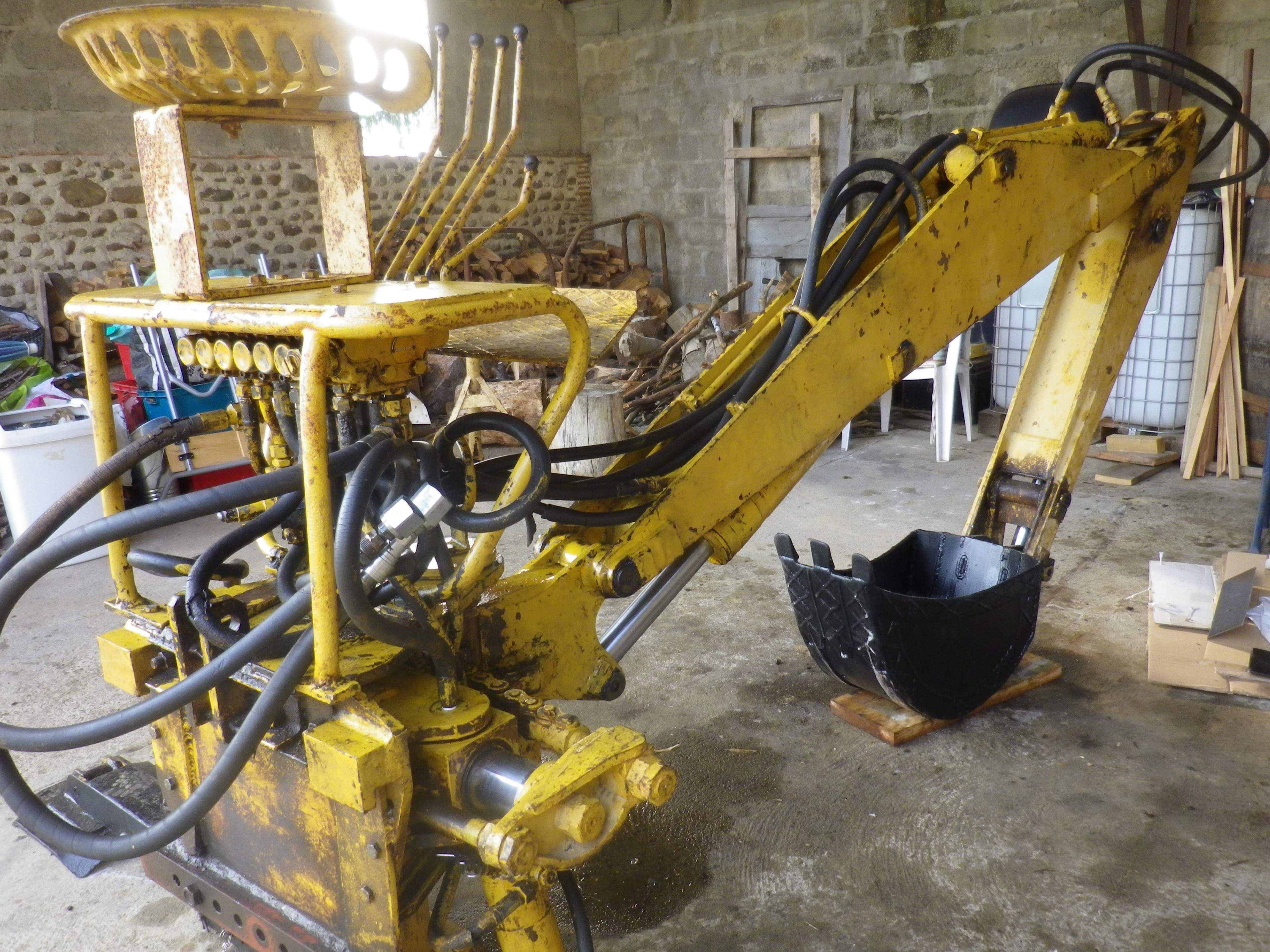

I have never seen anything like that. Could you post pictures of the manifold, some different angles and not too close up?
/ how is this valve suppose to work?
#12
Here are some photos. I am not near to my digger at the moment, so can't take any more photos just yet - but let me know what you need and I'll see what else I have, or I will take pictures later and post them.

There are no labels identifying the brand of the machine or where it came from - however there is a label on the manifold with an address in France. This is where it gets a bit strange - it turns out the company is H. K. Porter, the US manufacturer of locomotives. It seems up until about 1977 they made hydraulic systems in France.

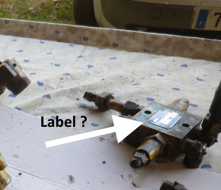

Here is the relief valve in question:
This should show who made the valves:

Yes, that is the valve in question.
The label you point out is slightly different to the one I mention just before. It is a company called ACX (? bit worn), which I assumed made the valve it is on - there is no address or other info, so I couldn't get anywhere with this.
#16
I went back to some old photos, when I first restored the machine years ago - the label was more readable then and I noted that the label you pointed out said Abex and Denison.
Denison is an old hydraulics company in France. I will chase this up. Thanks for pushing me in this direction - I had forgotten all about that label.

You're welcome. My best guess is that one is a crossover type relief valve, to set the maximum pressure going to the valve block.
Hope they made the valve block also, and you can get the info that you need for it.
