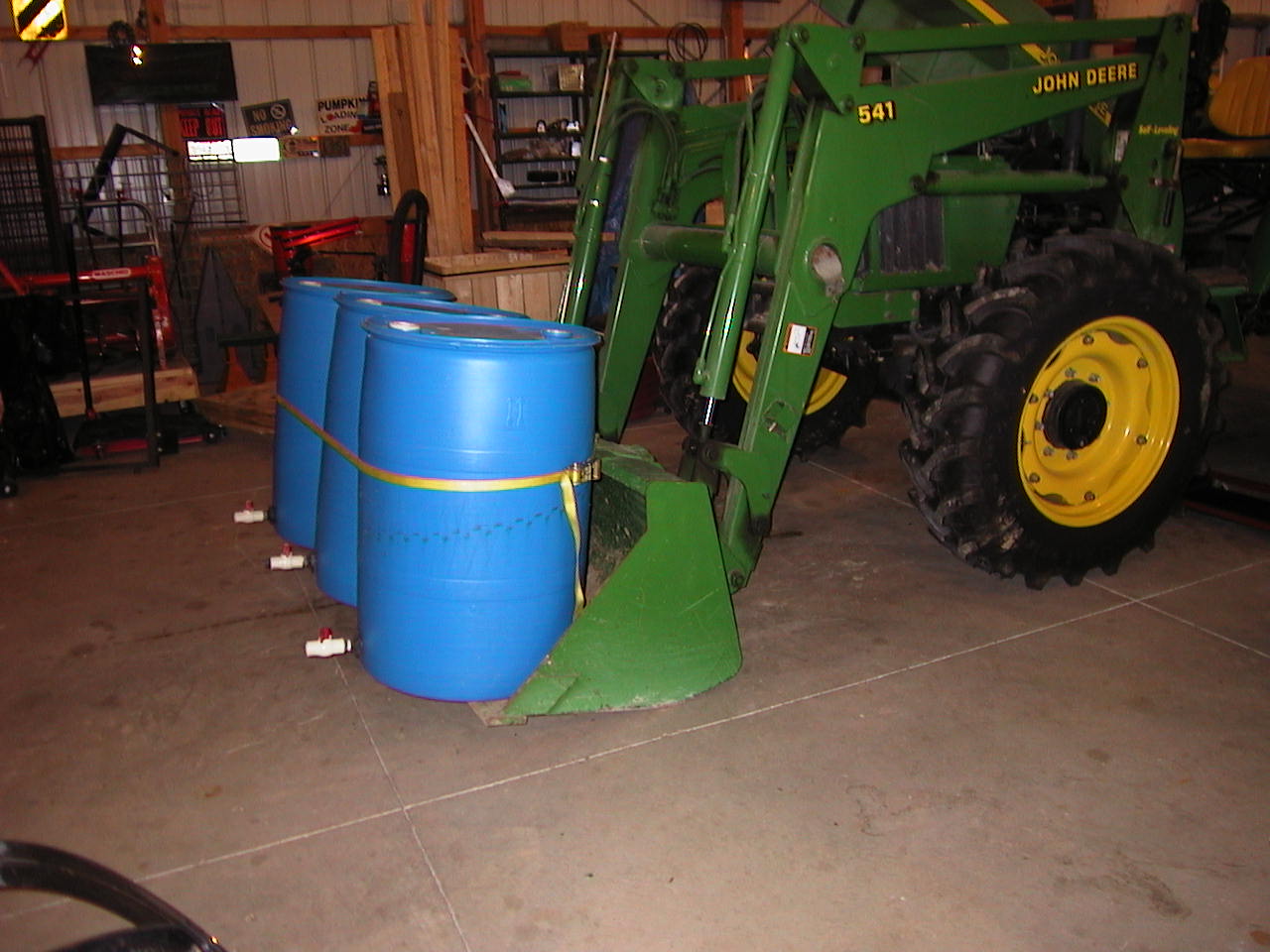

003.JPGHere is how I water my tree seedlings during the dry spells. I put three 55 gallon plastic drums in the loader bucket and chain or strap them in. First I drilled a hole in the side near the bottom and installed a plastic farm-type petcock with a garden hose adapter on it. It does not leak but you need long arms to install. Be careful, barrels can fall out of the loader if you are not careful.
I can use a short hose and raise the loader or just use to fill 5 gallon pails. I put other five gallon pails around the trees in which I drilled a small--3/16?--hole in the bottom. Then the water can drip out slowly and it does the tree a whole lot better. Anyway, here's a photo.

RobS--- you have all the essentials and that is a great setup. The rear platform does work fine and that actually was my first choice but I already had the loader and the buckets fit so that was the path of least resistance. Using the loader I can lift the buckets ten ft in the air and use a hose that the wife can direct the water.
She is not willing to do this any longer and the five gallon water bucket with a small hole in the bottom actually works better.
I think the hole-in-a-bucket idea was a major discovery because I have not seen it mentioned before.--See my inital post here but it gets every bit of water into the root zone and no runoff.
I think water is 8.5 lbs per gallon so 55 gallons is 467 lbs and three of them is 1400 lbs. But , all of my trees have lived, other than the ones I mowed by mistake.

Just thinking, instead of drilling a hole in the lower barrel section, would a pvc threaded adaptor fit in the bung hole? If so, then you could add the valves at the bung holes and not drill any more holes in the barrel. I hate cutting more holes in a good barrel. Of course, the barrels would have to be horizontal to work.

No can do Redbug--the barrels have no strength on their side. Upright is the only way. Barrels are cheap in the upper Greak Lakes area--they are old soy sauce containers from Wisconsin and you can buy for maybe $5-$7 each if you buy five.
I also cut the tops out --leaving the edge of the barrel intact for strength --and use to haul bulk fertilizer. And who knows, if the recession worsens I could add suspenders and save on farmyard attire.
